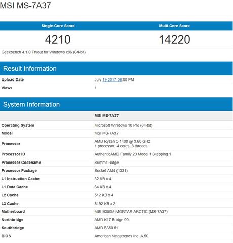

Madmax81
MSI B350M Mortar AM4 Motherboard Review
