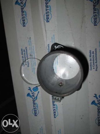

Sziasztok, K9K 724-es 1.5 dCi be miért ilyen picike a légtömegmérő elektronika??
Hol tudok venni jó áron újat?[L:/dl/upc/2016-01/29/71510_yrxzepihwqlemhvg_12630916_10206252562533238_1167941000_o_2.jpg](IMG:/dl/upc/2016-01/29/71510_yrxzepihwqlemhvg_12630916_10206252562533238_1167941000_o_2.thumb.jpg)(/IMG)[/L](/IMG)[/L] [L:/dl/upc/2016-01/29/71510_vcslxcr1sua2b8dt_12632796_10206252562653241_1065819338_o_2.jpg](IMG:/dl/upc/2016-01/29/71510_vcslxcr1sua2b8dt_12632796_10206252562653241_1065819338_o_2.thumb.jpg)[L:/dl/upc/2016-01/29/71510_yrxzepihwqlemhvg_12630916_10206252562533238_1167941000_o_2.jpg](IMG:/dl/upc/2016-01/29/71510_yrxzepihwqlemhvg_12630916_10206252562533238_1167941000_o_2.thumb.jpg)(/IMG)[/L](/IMG)[/L]](//cdn.rios.hu/dl/upc/2016-01/29/71510_utxmc1oiflvlstre_837235155_3_644x461_medidor-de-massa-ar-renaultmeg.jpg/800)
