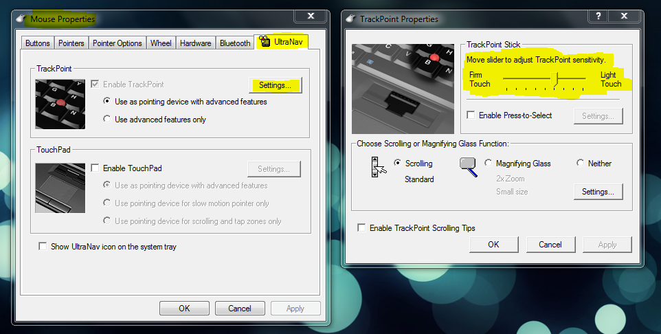

alapbol valoban kinszenvedes a TrackPoint, ilyen leszakad az ember ujja erzes.. a sensitivity-t kell felnyomni maxra, meg a speed-et is erdemes kicsit megpiszkalni.. ezeket sysfs-en keresztul elerheted:
/sys/devices/platform/i8042/serio1/serio2/sensitivity
/sys/devices/platform/i8042/serio1/serio2/speed
mind a ket ertek egy 1 bajtos integer.. nekem a sensitivity 255-re, a speed 200-ra van allitva, illetve a HAL configban is be van allitva egy 1.5-os sensitivity:
/etc/hal/fdi/policy/trackpoint.fdi-ben:<match key="info.product" string="PS/2 Mouse">
<merge key="input.x11_options.Sensitivity" type="string">1.5</merge>
</match>ez amugy nem tudom pontosan mit csinal, az elozo ketto kozvetlenul a TrackPoint hardver beallitasait birizgalja..
igy tenyleg csak hozza kell nyulni a pocokhoz, es mar szaguld is kurzor -

Create the file /usr/lib/X11/xorg.conf.d/20-thinkpad.conf as root with the following content:
Section "InputClass"
Identifier "Trackpoint Wheel Emulation"
MatchProduct "TPPS/2 IBM TrackPoint|DualPoint Stick|Synaptics Inc. Composite TouchPad / TrackPoint|ThinkPad USB Keyboard with TrackPoint"
MatchDevicePath "/dev/input/event*"
Option "EmulateWheel" "true"
Option "EmulateWheelButton" "2"
Option "Emulate3Buttons" "false"
Option "XAxisMapping" "6 7"
Option "YAxisMapping" "4 5"
EndSection -
