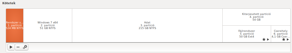

így?
# /etc/fstab: static file system information.
# Use 'blkid' to print the universally unique identifier for a
# device; this may be used with UUID= as a more robust way to name devices
# that works even if disks are added and removed. See fstab(5).
# <file system> <mount point> <type> <options> <dump> <pass>
# / was on /dev/sda5 during installation
UUID=10980915-62d2-4e63-8246-91130b026fee / ext4 errors=remount-ro 0 1
# /home was on /dev/sda6 during installation
UUID=dabd1c69-26f7-43d5-b820-30c3e9087b64 /home ext4 defaults 0 2
# swap was on /dev/sda7 during installation
UUID=4a0c75c3-e941-4e54-9e68-34e706d694e3 none swap sw 0 0
# /was on /dev/sda3: UUID=1244F90C44F8F2F9 /media/batai15/Új kötet NTFS auto,nofail,noatime 0 0 -
batai15
ubyegon2
#30128
[sudo] batai15 jelszava:
/dev/sda1: LABEL="faszom" UUID="811b2446-be30-425a-ac49-d0d2fdfed661" TYPE="ext4" PARTUUID="ba36ce15-01"
/dev/sda3: LABEL="M-CM-^Zj kM-CM-6tet" UUID="1244F90C44F8F2F9" TYPE="ntfs" PARTUUID="ba36ce15-03"
/dev/sda5: UUID="10980915-62d2-4e63-8246-91130b026fee" TYPE="ext4" PARTUUID="ba36ce15-05"
/dev/sda6: UUID="dabd1c69-26f7-43d5-b820-30c3e9087b64" TYPE="ext4" PARTUUID="ba36ce15-06"
/dev/sda7: UUID="4a0c75c3-e941-4e54-9e68-34e706d694e3" TYPE="swap" PARTUUID="ba36ce15-07"
/dev/sdb1: UUID="3B84-11E2" TYPE="vfat" -
batai15
ubyegon2
#30123
igen, az adat partíciom ami ntfs arra van beállítva, elméletileg folyamatosan csatolva van, legalábbis gondolom , mert mindíg látszódik (szerintem)
