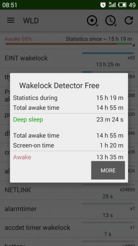

Tybe3e
Egy kisebb Google keresés után ilyet találtam:
"...I learned that the culprit is the EINT wake lock and that it is related to the wifi chip not being put properly into sleep mode. So one solution is to make sure that your wifi gets automatically turned off when you don’t need it.
I’m using the Xposed module ‘Smart Network’ so that my wifi is turned off whenever my screen is turned off. The module ensures that wifi turns on again whenever my screen turns on. That way I have my wifi connection on when I’m actively using the phone and have the wifi off when I’m not actively using the phone. This has improved my wake lock situation significantly."
Szóval a wifi nem kapcsolódik rendesen alvó módba, "beragad". Megoldás lehet kikapcsolni, ha amúgy nem használod hogy ne menjen a háttérben, vagy ha használsz Xposed-et, akkor a Smart Network modul is megoldás lehet.
