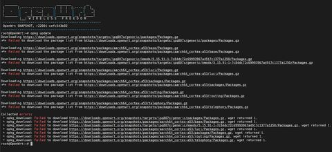

    Ha a "/etc/opkg/distfeeds.conf" fajlban atirod a https protokollt http-re, az meggyogyitja?
  • netcore
    A wolf mentes verziók ilyet produkálnak, másnál is előfordul esetleg?
    A webes felületen pedig :The opkg update command failed with code 7.

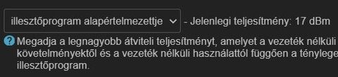

    A TX power egyelőre nem OK, de manuálisan is be tudod állítani:
    Megnyitod az /etc/config/wireless fájlt, és manuálisan beírod a kívánt TX power szintet.
    pl:
    config wifi-device 'radio2'
        option type 'mac80211'
        option path 'platform/soc/c000000.wifi+1'
        option band '2g'
        option cell_density '0'
        option txpower '20'
        option htmode 'HE40'
        option channel '3'
    Utána a wifit újraindítod

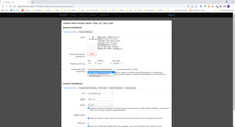

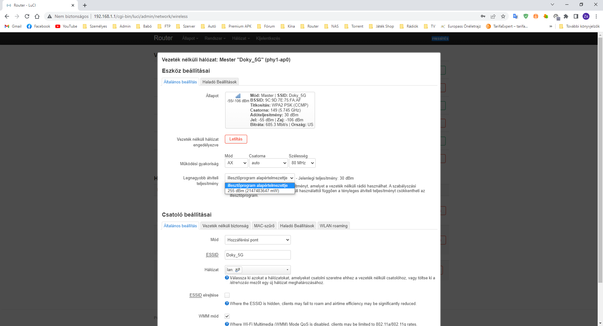

  • Doky1988
    Hali!
    Ezzel az 5G WIFI 255dBm -el lehet valamit kezdeni? Vagy majd javítva lesz és kész?
    Illetve frissítés előtt miért kell a service wpad stop ? Mi célt szolgál, hogy lekell lőni a wifit?

    Viszont egy ujabb hiba:
    Executing package managerDownloading https://downloads.openwrt.org/snapshots/targets/ipq807x/generic/packages/Packages.gz *** Failed to download the package list from https://downloads.openwrt.org/snapshots/targets/ipq807x/generic/packages/Packages.gz Downloading https://downloads.openwrt.org/snapshots/packages/aarch64_cortex-a53/base/Packages.gz *** Failed to download the package list from https://downloads.openwrt.org/snapshots/packages/aarch64_cortex-a53/base/Packages.gz Downloading https://downloads.openwrt.org/snapshots/targets/ipq807x/generic/kmods/5.15.90-1-be2b356849622680d297c7c22f2bb4c0/Packages.gz *** Failed to download the package list from https://downloads.openwrt.org/snapshots/targets/ipq807x/generic/kmods/5.15.90-1-be2b356849622680d297c7c22f2bb4c0/Packages.gz Downloading https://downloads.openwrt.org/snapshots/packages/aarch64_cortex-a53/luci/Packages.gz *** Failed to download the package list from https://downloads.openwrt.org/snapshots/packages/aarch64_cortex-a53/luci/Packages.gz Downloading https://downloads.openwrt.org/snapshots/packages/aarch64_cortex-a53/packages/Packages.gz *** Failed to download the package list from https://downloads.openwrt.org/snapshots/packages/aarch64_cortex-a53/packages/Packages.gz Downloading https://downloads.openwrt.org/snapshots/packages/aarch64_cortex-a53/routing/Packages.gz *** Failed to download the package list from https://downloads.openwrt.org/snapshots/packages/aarch64_cortex-a53/routing/Packages.gz Downloading https://downloads.openwrt.org/snapshots/packages/aarch64_cortex-a53/telephony/Packages.gz *** Failed to download the package list from https://downloads.openwrt.org/snapshots/packages/aarch64_cortex-a53/telephony/Packages.gz

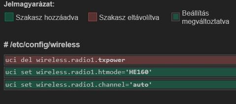

    Írtam a 160MHz anomáliáról, most szembesültem vele, hogy a 2,4GHz frekin hiába állítom be a 40MHz sávszélt, csak 20-on megy. Valaki meg tudná még nézni?

    Felraktam az új firmwaret, maradt minden a régiben - 160MHz, TX kiválasztási anomália

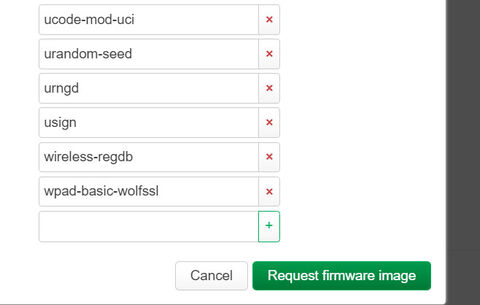

    A wolfssl a baja. Két lehetőséged van. Vagy vársz amíg javítják vagy kigyomlalod a wolfssl-t és teszek fel helyette openssl-t. Utána működni fog az Attended Sysupgrade.

    Ma probaltam sysupgrade-t, a kovetkezo hibat adta. A wpad le volt allitva.
    Nm olyan hosszu a log, inkabb ide tettem.
    Package list missing or not up-to-date, generating it. Building package index... Downloading https://downloads.openwrt.org/snapshots/targets/ipq807x/generic/packages/Packages.gz Updated list of available packages in /home/aparcar/asu/worker1/cache/SNAPSHOT/ipq807x/generic/build_dir/target-aarch64_cortex-a53_musl/root-ipq807x/../../../../../../../../../../../home/aparcar/asu/worker1/cache/SNAPSHOT/ipq807x/generic/dl/openwrt_core Downloading https://downloads.openwrt.org/snapshots/targets/ipq807x/generic/packages/Packages.sig Signature check passed. Downloading https://downloads.openwrt.org/snapshots/packages/aarch64_cortex-a53/base/Packages.gz Updated list of available packages in /home/aparcar/asu/worker1/cache/SNAPSHOT/ipq807x/generic/build_dir/target-aarch64_cortex-a53_musl/root-ipq807x/../../../../../../../../../../../home/aparcar/asu/worker1/cache/SNAPSHOT/ipq807x/generic/dl/openwrt_base Downloading https://downloads.openwrt.org/snapshots/packages/aarch64_cortex-a53/base/Packages.sig Signature check passed. Downloading https://downloads.openwrt.org/snapshots/targets/ipq807x/generic/kmods/5.15.90-1-0fa92db7c38bee0774cabc5f0be2cda5/Packages.gz Updated list of available packages in /home/aparcar/asu/worker1/cache/SNAPSHOT/ipq807x/generic/build_dir/target-aarch64_cortex-a53_musl/root-ipq807x/../../../../../../../../../../../home/aparcar/asu/worker1/cache/SNAPSHOT/ipq807x/generic/dl/openwrt_kmods Downloading https://downloads.openwrt.org/snapshots/targets/ipq807x/generic/kmods/5.15.90-1-0fa92db7c38bee0774cabc5f0be2cda5/Packages.sig Signature check passed. Downloading https://downloads.openwrt.org/snapshots/packages/aarch64_cortex-a53/luci/Packages.gz Updated list of available packages in /home/aparcar/asu/worker1/cache/SNAPSHOT/ipq807x/generic/build_dir/target-aarch64_cortex-a53_musl/root-ipq807x/../../../../../../../../../../../home/aparcar/asu/worker1/cache/SNAPSHOT/ipq807x/generic/dl/openwrt_luci Downloading https://downloads.openwrt.org/snapshots/packages/aarch64_cortex-a53/luci/Packages.sig Signature check passed. Downloading https://downloads.openwrt.org/snapshots/packages/aarch64_cortex-a53/packages/Packages.gz Updated list of available packages in /home/aparcar/asu/worker1/cache/SNAPSHOT/ipq807x/generic/build_dir/target-aarch64_cortex-a53_musl/root-ipq807x/../../../../../../../../../../../home/aparcar/asu/worker1/cache/SNAPSHOT/ipq807x/generic/dl/openwrt_packages Downloading https://downloads.openwrt.org/snapshots/packages/aarch64_cortex-a53/packages/Packages.sig Signature check passed. Downloading https://downloads.openwrt.org/snapshots/packages/aarch64_cortex-a53/routing/Packages.gz Updated list of available packages in /home/aparcar/asu/worker1/cache/SNAPSHOT/ipq807x/generic/build_dir/target-aarch64_cortex-a53_musl/root-ipq807x/../../../../../../../../../../../home/aparcar/asu/worker1/cache/SNAPSHOT/ipq807x/generic/dl/openwrt_routing Downloading https://downloads.openwrt.org/snapshots/packages/aarch64_cortex-a53/routing/Packages.sig Signature check passed. Downloading https://downloads.openwrt.org/snapshots/packages/aarch64_cortex-a53/telephony/Packages.gz Updated list of available packages in /home/aparcar/asu/worker1/cache/SNAPSHOT/ipq807x/generic/build_dir/target-aarch64_cortex-a53_musl/root-ipq807x/../../../../../../../../../../../home/aparcar/asu/worker1/cache/SNAPSHOT/ipq807x/generic/dl/openwrt_telephony Downloading https://downloads.openwrt.org/snapshots/packages/aarch64_cortex-a53/telephony/Packages.sig Signature check passed. Downloading file:packages/Packages Updated list of available packages in /home/aparcar/asu/worker1/cache/SNAPSHOT/ipq807x/generic/build_dir/target-aarch64_cortex-a53_musl/root-ipq807x/../../../../../../../../../../../home/aparcar/asu/worker1/cache/SNAPSHOT/ipq807x/generic/dl/imagebuilder Downloading file:packages/Packages.sig Signature check failed. Remove wrong Signature file. [libwolfsslcpu-crypto] Checking for Arm v8-A Cryptographic Extension support: ...[offline]... OK [libwolfsslcpu-crypto] Checking for Arm v8-A Cryptographic Extension support: ...[offline]... OK Collected errors: * check_data_file_clashes: Package libwolfsslcpu-crypto5.5.4.e624513f wants to install file /home/aparcar/asu/worker1/cache/SNAPSHOT/ipq807x/generic/build_dir/target-aarch64_cortex-a53_musl/root-ipq807x/usr/lib/libwolfssl.so.5.5.4.e624513f But that file is already provided by package * libwolfssl5.5.4.e624513f * opkg_install_cmd: Cannot install package libwolfsslcpu-crypto. * check_data_file_clashes: Package libwolfsslcpu-crypto5.5.4.e624513f wants to install file /home/aparcar/asu/worker1/cache/SNAPSHOT/ipq807x/generic/build_dir/target-aarch64_cortex-a53_musl/root-ipq807x/usr/lib/libwolfssl.so.5.5.4.e624513f But that file is already provided by package * libwolfssl5.5.4.e624513f * opkg_install_cmd: Cannot install package libwolfsslcpu-crypto. make[2]: *** [Makefile:185: package_install] Error 255 make[1]: *** [Makefile:150: _call_manifest] Error 2 make: *** [Makefile:269: manifest] Error 2

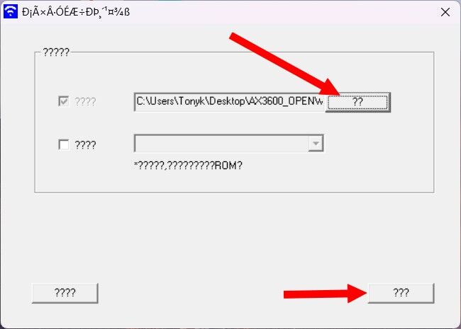

    1. letöltöd ezt a programot: [link] (jelszó: miwifi ) .
    2. letöltöd a kívánt gyári firmware-t.

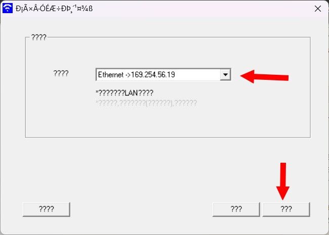

    3. A gépedben lévő hálókártyának adj fix ip-t: 192.168.31.100
    4. Elindítod a letöltött programot. (AV-t és Tűzfalat kapcsold ki!!!)
    5. Első ablakban betallózod a gyári fw-t. [kép]
    6. Következő ablakban, kiválasztod a hálózati kártyát, aminek az előbb ip-t adtál. [kép]

    Mentéskor itt törli a txpower beállításokat is, ezt kézzel, manuálisan orvoslom utána, különben csak a default, vagy 255dBm marad kiválasztható (ami ugyanúgy 1W, de ha kézzel beállítom a pl. 17dBm-et, akkor azzal a teljesítménnyel megy valóban is - ezt ki is jelzi, mobilon wifi analiyzerrel nézve is stimm)
  • Benny21
    Hali srácok! AX3600 két particiós változatról tértem át openwrt verzióra. A openwrt oldal leírása szerint + itteni leírások alapján. Kérdésem. Hogyan lehet visszaállni eredeti xiaomi fw verzióra? Van rá mód?

  • Tonyk
    válasz Laza... #5519 üzenetére
    Válts csatornát, vagy auto-ra tedd (+US régió). Nálam ez jött be. Pl.: 80Mhz-en, nálam csak a 36 és 132-es csatornán volt hajlandó működni. A többin (52, 100, 116, 149) elérhetetlen volt.

  • Laza...
    válasz dchard #5516 üzenetére
    Ismét sikerült előidéznem az 5GHz elérhetetlenségét. A jelenség 80MHz sávszélességből 160MHz-re váltáskor jött létre. Enable-disable radio nem segít, az ehhez tartozó log:
    Sun Jan 29 11:37:07 2023 daemon.notice hostapd: Remove interface 'phy1-ap0'
    Sun Jan 29 11:37:07 2023 daemon.notice hostapd: phy1-ap0: interface state DISABLED->DISABLED
    Sun Jan 29 11:37:07 2023 daemon.notice hostapd: phy1-ap0: AP-DISABLED
    Sun Jan 29 11:37:07 2023 daemon.notice hostapd: phy1-ap0: CTRL-EVENT-TERMINATING
    Sun Jan 29 11:37:07 2023 daemon.err hostapd: rmdir[ctrl_interface=/var/run/hostapd]: Permission denied
    Sun Jan 29 11:37:07 2023 daemon.err hostapd: hostapd_free_hapd_data: Interface phy1-ap0 wasn't started
    Sun Jan 29 11:37:07 2023 daemon.notice netifd: Wireless device 'radio1' is now down
    Sun Jan 29 11:37:07 2023 daemon.notice hostapd: Configuration file: /var/run/hostapd-phy1.conf (phy phy1-ap0) --> new PHY
    Sun Jan 29 11:37:07 2023 kern.info kernel: [90728.725092] br-lan: port 4(phy1-ap0) entered blocking state
    Sun Jan 29 11:37:07 2023 kern.info kernel: [90728.725139] br-lan: port 4(phy1-ap0) entered disabled state
    Sun Jan 29 11:37:07 2023 kern.info kernel: [90728.729838] device phy1-ap0 entered promiscuous mode
    Sun Jan 29 11:37:07 2023 kern.info kernel: [90728.735159] br-lan: port 4(phy1-ap0) entered blocking state
    Sun Jan 29 11:37:07 2023 kern.info kernel: [90728.740270] br-lan: port 4(phy1-ap0) entered forwarding state
    Sun Jan 29 11:37:07 2023 kern.info kernel: [90728.746112] br-lan: port 4(phy1-ap0) entered disabled state
    Sun Jan 29 11:37:07 2023 daemon.notice hostapd: ACS: Automatic channel selection started, this may take a bit
    Sun Jan 29 11:37:07 2023 daemon.notice hostapd: phy1-ap0: interface state UNINITIALIZED->ACS
    Sun Jan 29 11:37:07 2023 daemon.notice hostapd: phy1-ap0: ACS-STARTED
    Sun Jan 29 11:37:08 2023 daemon.notice netifd: Wireless device 'radio1' is now up
    Sun Jan 29 11:37:15 2023 daemon.err hostapd: ACS: Failed to compute ideal channel
    Sun Jan 29 11:37:15 2023 daemon.err hostapd: Interface initialization failed
    Sun Jan 29 11:37:15 2023 daemon.notice hostapd: phy1-ap0: interface state ACS->DISABLED
    Sun Jan 29 11:37:15 2023 daemon.notice hostapd: phy1-ap0: AP-DISABLED
    Sun Jan 29 11:37:15 2023 daemon.err hostapd: ACS: Possibly channel configuration is invalid, please report this along with your config file.
    Sun Jan 29 11:37:15 2023 daemon.err hostapd: ACS: Failed to start
    Sun Jan 29 11:37:15 2023 daemon.err hostapd: hostapd_free_hapd_data: Interface phy1-ap0 wasn't started
    Sun Jan 29 11:37:15 2023 daemon.notice hostapd: nl80211: deinit ifname=phy1-ap0 disabled_11b_rates=0
    Sun Jan 29 11:37:15 2023 kern.info kernel: [90736.128496] device phy1-ap0 left promiscuous mode
    Sun Jan 29 11:37:15 2023 kern.info kernel: [90736.128652] br-lan: port 4(phy1-ap0) entered disabled state
    Sun Jan 29 11:37:15 2023 daemon.notice hostapd: phy1-ap0: interface state DISABLED->DISABLED

  • Laza...
    válasz mano42 #5511 üzenetére
    Nekem van egy kapcsolóm, ami nem bírja elviselni a túl nagy wifi jelet, úgyhogy az IoT-ot beüzemelve, és levéve 1mW teljesítményre megoldódott minden gondom. Úgyhogy nálam van neki létjogosultsága
    Felpattintottam a legújabb firmwaret, egyúttal frissítettem utána az egyéb csomagokat is (mert jelezte hogy van frissebb), és Luci rögtön elszállt. Úgyhogy 2x kellett felraknom :D :W
    Titkosítás kijelzés jó lett, a wifi teljesítmény beállítás maradt bugos

    Ha már úgyis van benne egy "iot" interfész, aktivaltam egy vlant az összes okos eszköznek a QCA9887 részére. Sajnos csalódás, a távolabbi eszközök többet vannak offline mint online. Kénytelen voltam átköltöztetni az egészet a IPQ8074 802.11axbgn interfészre, itt minden atomstabil. Nem értem mi volt a xiaomi fejében amikor integrálta ezt az spéci iot antennát.
  • tlala
    válasz xabolcs #5500 üzenetére
    Nálam így néz ki az Attended Sysupgrade menü (advanced engedélyezve).
    Szóval ki lehet kattintgatni ami nem kell, és alulra be lehet írni, ami kéne.
