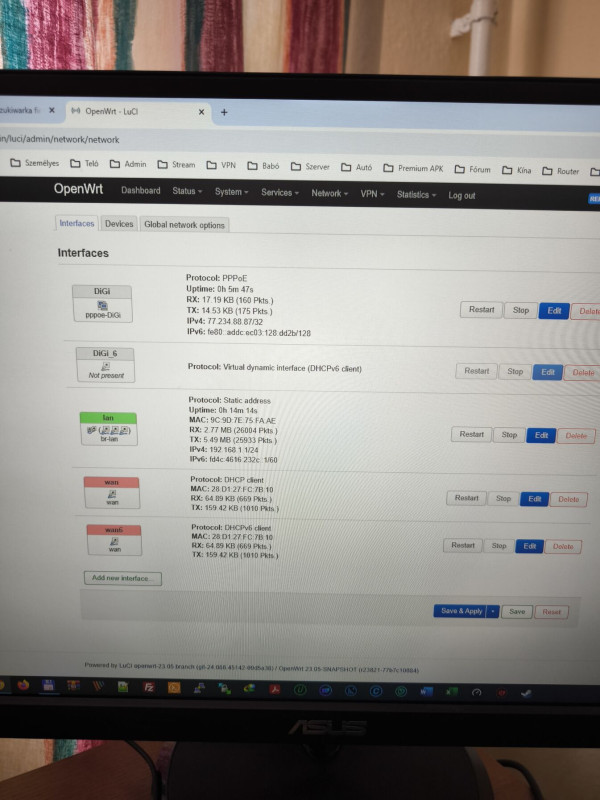

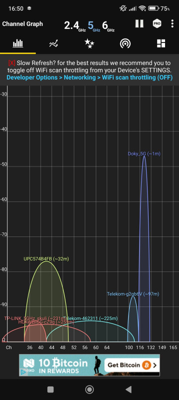

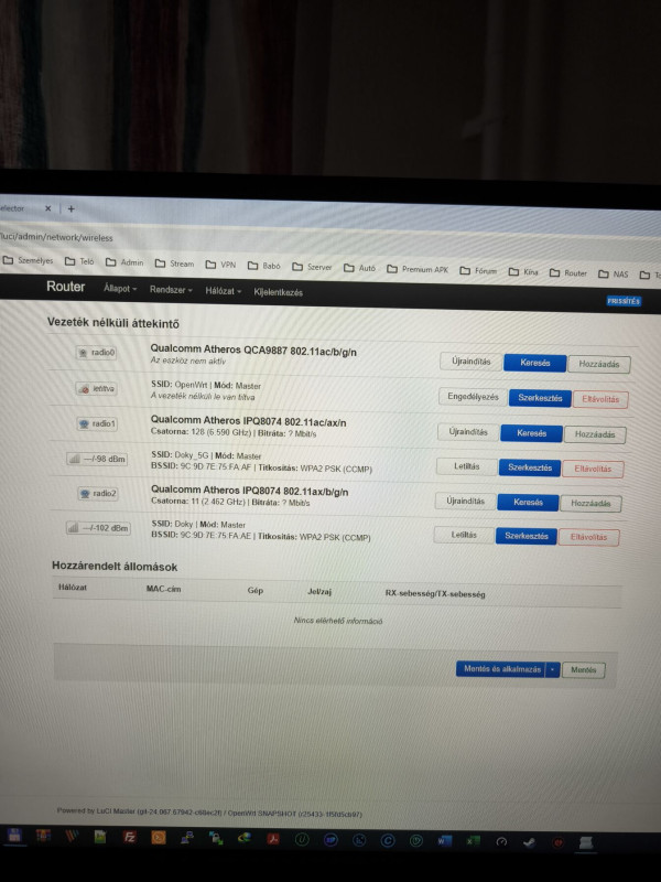

OpenWRT-n mennyire ajánlott a Dual Wifi? Arra gondolok hogy 1 WIFI van csak, és az tudja 2.4/5Ghzet? Illetve hogy lehet ezt beállítani? Azonos SSID illetve azonos titkosítás kell csak és ennyi? Mennyire akadályozhat ez bármilyen készüléket?

I'm sorry for speaking English, but I found this forum thread after having big issues with my AX3600 running 3.0.22 (stock firmware with SSH enabled). After restoring the device and reinstalling firmware I am having issues with Wifi, it seems like /etc/config/wireless is missing completely. So the file system has not been rewritten when I reinstalled the firmware.
Found this firmware by one of your users, which seems to remove bloat:
https://prohardver.hu/tema/xiaomi_ax3600_wifi_6_aiot_router/hsz_2305-2305.html
Is this a good choice in 2024? Also heard about this NSS OpenWRT firmware, but I am not sure it will be stable enough to run on my daily router: https://forum.openwrt.org/t/ipq807x-nss-build/148529/2088What do you recommend? And do you know how to restore the firmware and filesystem completely when installing stock firmware?
Thank you!
Hope it is OK with my English! -

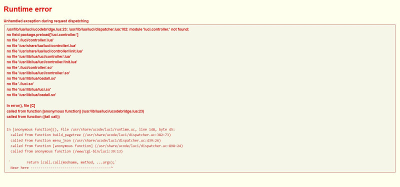

Most, hogy a legutobbi (OpenWrt SNAPSHOT, r25721-b04f245c39) frissitesem bemondta az unalmast WiFi teren ... :
Mon Apr 1 09:15:59 2024 daemon.notice netifd: radio0 (2685): Syntax error: Unable to compile module '/usr/share/hostap/common.uc':
Mon Apr 1 09:15:59 2024 daemon.notice netifd: radio0 (2685): | Syntax error: Unable to resolve path for module 'rtnl'
Mon Apr 1 09:15:59 2024 daemon.notice netifd: radio0 (2685): | In /usr/share/hostap/common.uc, line 2, byte 29:
Mon Apr 1 09:15:59 2024 daemon.notice netifd: radio0 (2685): | `import * as rtnl from "rtnl";`
Mon Apr 1 09:15:59 2024 daemon.notice netifd: radio0 (2685): | Near here ------------------^
Mon Apr 1 09:15:59 2024 daemon.notice netifd: radio0 (2685): In /usr/share/hostap/wdev.uc, line 3, byte 137:
Mon Apr 1 09:15:59 2024 daemon.notice netifd: radio0 (2685): `import { vlist_new, is_equal, wdev_create, wdev_set_mesh_params, wdev_remove, wdev_set_up, phy_open } from "/usr/share/hostap/common.uc";`
Mon Apr 1 09:15:59 2024 daemon.notice netifd: radio0 (2685): Near here ------------------------------------------------------------------------------------------------------------------------------^
Mon Apr 1 09:15:59 2024 daemon.notice netifd: radio1 (2686): Command failed: Not found
Mon Apr 1 09:15:59 2024 daemon.notice netifd: radio1 (2686): Syntax error: Unable to compile module '/usr/share/hostap/common.uc':
Mon Apr 1 09:15:59 2024 daemon.notice netifd: radio1 (2686): | Syntax error: Unable to resolve path for module 'rtnl'
Mon Apr 1 09:15:59 2024 daemon.notice netifd: radio1 (2686): | In /usr/share/hostap/common.uc, line 2, byte 29:
Mon Apr 1 09:15:59 2024 daemon.notice netifd: radio1 (2686): | `import * as rtnl from "rtnl";`
Mon Apr 1 09:15:59 2024 daemon.notice netifd: radio1 (2686): | Near here ------------------^
Mon Apr 1 09:15:59 2024 daemon.notice netifd: radio1 (2686): In /usr/share/hostap/wdev.uc, line 3, byte 137:
Mon Apr 1 09:15:59 2024 daemon.notice netifd: radio1 (2686): `import { vlist_new, is_equal, wdev_create, wdev_set_mesh_params, wdev_remove, wdev_set_up, phy_open } from "/usr/share/hostap/common.uc";`
Mon Apr 1 09:15:59 2024 daemon.notice netifd: radio1 (2686): Near here ------------------------------------------------------------------------------------------------------------------------------^
Mon Apr 1 09:15:59 2024 daemon.notice netifd: radio0 (2685): ./mac80211.sh: eval: line 597: /usr/sbin/hostapd: not found
Mon Apr 1 09:15:59 2024 daemon.notice netifd: radio1 (2686): ./mac80211.sh: eval: line 597: /usr/sbin/hostapd: not found

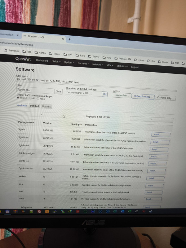

Mon Apr 1 09:15:59 2024 daemon.notice netifd: radio0 (2685):... vettem a batorsagot, s kiprobaltam AgustinLorenzo 807x NSS Build-jet, de nem Xiaomi AX3600 AIoT routeren, hanem a szinten a qualcommax/ipx807x csaladba tartozo Dynalink DL-WRX36-tal.
Eddig minden rendben:
- DIGI PPPoE 1000/300 hardveresen gyorsitva alapbol
- Wifi hardveresen gyorsitva alapbolEddig tetszik!
Magat az eszkozt nem hasznalom semmi masra: router + AP -

Doky1988
#6562
Hacsak nem NZ-ben élsz, magyaron is kéne használni. A DFS nagyon leegyszerűsítve radar érzékelést jelent. Ennek egyértelmű jele van a logban. Ahogyan korábban már számtalanszor leírtuk: magas csatornán is megy, 10 perc után, addig tart a DFS radar érzékelés (minden EU országban egyébként).

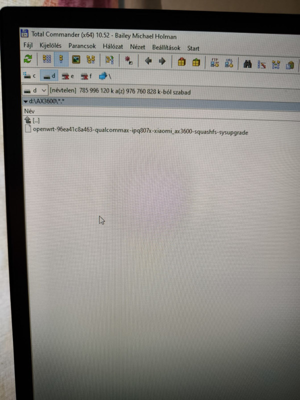

Hali.
No nagy nehezen sikerült.. Voltak érdekes dolgok, felraktam az ubi filet, nem volt benne luci.. mondom visszaállítom tmp -ből a mentett beállításaim (még jóhogy volt), hogy PPPOE belegyen állítva, és legyen netem... persze az istennek se akarta az igazat, visszatöltötte, rebootot nyomtam, erre visszajött a miwifi 1.0.17
Nem volt gyenge feladat visszarakni az openwrt -t

No most probléma a következő!
TFTP -s módszerrel visszatettem a gyári 1.0.17-es Fw-t, belőttem netet, meg amit kell alapot megy..
Viszont, letöltöttem az itt: [link] említett .ubi factory fájlt, a 7-es pontig megcsináltam mindent, majd jön a 8-as pont: 8. Újraindítod a routert. Belépsz a 192.168.1.1 -es IP-n!, állítasz egy root jelszót.
Újraindítom a routert, és narancssárgán csak világít, nem csinál semmit sem. Se SSH, se Telnet, se SCP semmi nem müxik! Mi lehet a probléma oka? Valami partíciós probléma? Mert onnan tovább nem jutok sehogy sem sajna.

Doky1988
Ok, TFTPvel sikerült visszalőni gyárira
Kérdés mostmár, OpenWRThez még mindig a hackelgetős módszer megy? -

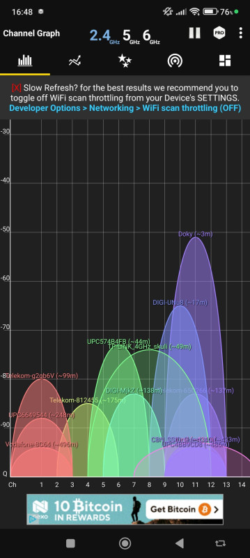

Meglett közben

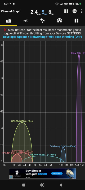

US-re kell állítani a WIFI Country -t, és 161-es csatornán remekül muzsikál! Köszi, meginn tanultam valamit
DFS support almost triples the available channels in the 5 GHz ISM band. This allows for higher densities of APs, more Wi-Fi devices, and faster data transfer rates. For the U.S., there are nine non-DFS channels: 36, 40, 44, 48, 149, 153, 157, 161, and 165. There are 16 DFS channels: 52, 56, 60, 64, 100, 104, 108, 112, 116, 120, 124, 128, 132, 136, 140, and 144.
