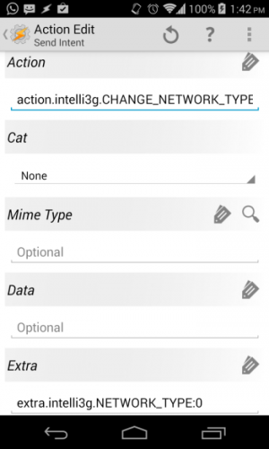

RCH
és a hálózati módok (az extra sor kettôspontja után kell megadni):
WCDMA_PREF = 0; /* GSM/WCDMA (WCDMA preferred) */
GSM_ONLY = 1; /* GSM only */
WCDMA_ONLY = 2; /* WCDMA only */
GSM_UMTS = 3; /* GSM/WCDMA (auto mode, according to PRL) */
CDMA = 4; /* CDMA and EvDo (auto mode, according to PRL) */
CDMA_NO_EVDO = 5; /* CDMA only */
EVDO_NO_CDMA = 6; /* EvDo only */
GLOBAL = 7; /* GSM/WCDMA, CDMA, and EvDo (auto mode, according to PRL) */
LTE_CDMA_EVDO = 8; /* LTE, CDMA and EvDo */
LTE_GSM_WCDMA = 9; /* LTE, GSM/WCDMA */
LTE_CMDA_EVDO_GSM_WCDMA = 10; /* LTE, CDMA, EvDo, GSM/WCDMA */
LTE_ONLY = 11; /* LTE Only mode. */
LTE_WCDMA = 12; /* LTE/WCDMA */Forrás: http://forum.xda-developers.com/showpost.php?p=49542442&postcount=208
