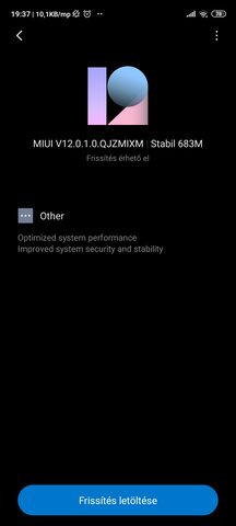

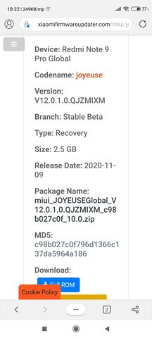

Globalra kijott a MIUI 12 - Telegram-rol az info:
New update available! (via OTA)
Device: Redmi Note 9 Pro Global
Codename: #joyeuse
Type: Stable Beta Recovery
Version: V12.0.1.0.QJZMIXM | 10.0
MD5: c98b027c0f796d1366c137da5964a186
Changelog:
[Other]
Optimized system performance
Improved system security and stabilityhttps://bigota.d.miui.com/V12.0.1.0.QJZMIXM/miui_JOYEUSEGlobal_V12.0.1.0.QJZMIXM_c98b027c0f_10.0.zip
