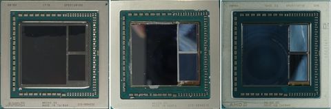

Látszatra egyértelműen az a legminőségibb csomagolás
Még az lenne kalandos, ha az is kiderülne, hogy a lapkát is több helyen gyártják -
Malibutomi
Igy elso blikkre is a Taiwan-it vennem inkabb

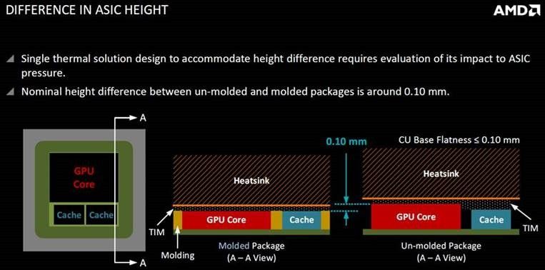

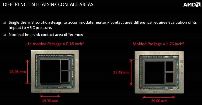

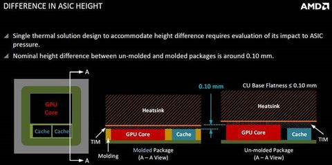

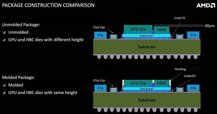

Csamcsogni valo a custom kartyakhoz: Vega10 variansok
The existence of multiple variants causes a lot of problems for board partners.
board partners are experimenting with different screw lengths to avoid potential heat problems. It may not be an issue for GPU cooling, but bear in mind the cooler is also attached to VRM section. A small difference there, means that the cooler is also misaligned elsewhere.
AMD has a special presentation for board partners explaining the difference for all Vega 10 variants.
