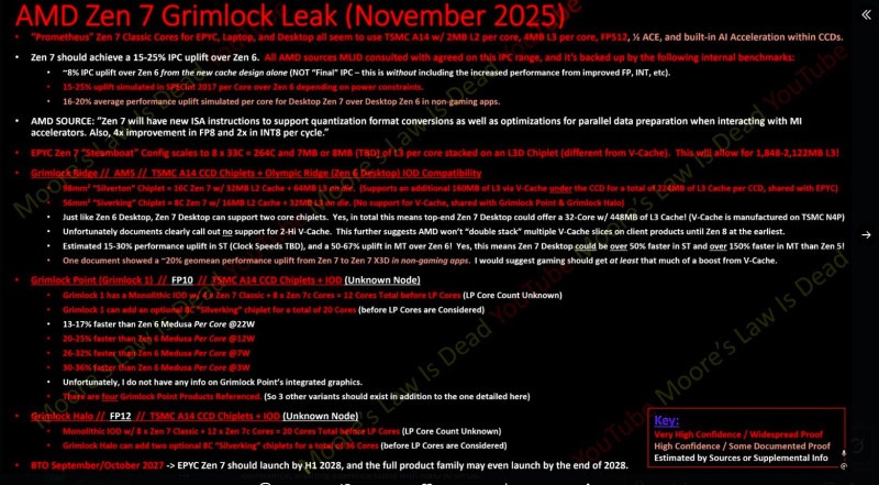

(MLID) zen7 pletyka:
AMD Zen 7, Grimlock
- A14 node for CCD, N4P for V-Cache / CCD ~98mm2
- Up to 16C per CCD
- FP512, 2MB L2, 4MB L3 per core
- EPYC is up to 264C, 2122MB L3 Cache (wo. 3D Cache)
- overall ~20% perf increase in non-gaming
- 160MB X3D Cache
- 20~36% faster than Zen 6 at 3~12W
https://x.com/harukaze5719/status/1986996913644978207 -

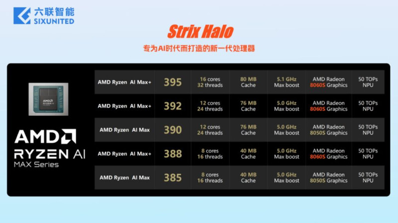

Az új Strix Halo - cpu-nál pedig ,
csak a CPU-t vágták vissza, a GPU maradt max-on ( 8060S )
