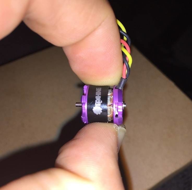

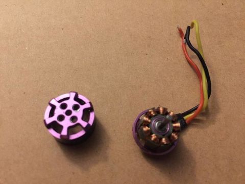

vandor01 #48000 üzenetére
igy jarnak mint en!
puha keves vekony az aluminim azt befosik hol itt hol ott csavarmenet vagy tengely az aluhazban...
szomoru....Maybe I just got a bad set but the two replacement motors I ordered both broke very easily. The center shaft is not well secured so it slid down out of the bottom of the motor making the motor useless. I hope I just got some bad ones and the next set will be more durable. Otherwise Ill switch brands. I cant recommend these unless my next set is much better.
