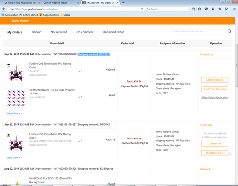

vandor01
rokarudi #49730 üzenetére
Ali-Rc Toy store....
ez az altalanos uzletmenet...
ide-oda kuldik vagy siman csak elbasszak...
Kinai regelt TN szamot fizetsz azt torok kovethetetlent kapsz!
60nap utan disput... 95napra beesik a cucc... azt kesobb fizetsz....no comment...
Dear buyer,
Thanks for your email.
Sorry for the trouble but we have given you a wrong tracking number before due to the problem of our system. You can track your parcel from the following link: http://www.17track.net/en/track?nums=RE244989513SE The post told us that your package was returned. We have sent your goods out on November 02, 2017, the shipping time will take 15-35 working days normally. But sometimes the parcels will be delayed due to some reasons, hope you could wait for your item patiently. By the way, we have extended the delivery time for you.
Have a nice day!
RegardsAbout this order
Order number: 504410548691736
Due to shipping delays,please extend delivery date by 23 days.Me
17/11/06 03:14HI,
I saw this ordered was delivered into somewhere but not for me! Please check TN number is correct! Is it for me? RU783851719CN
I ordered it into Belgium/Bruxelles!
But it was delivered into COMINES-WARNETON ???
So I did not get it!
03/11/2017 11:49 Item delivered COMINES-WARNETON MAIL
03/11/2017 07:46 Item in distribution phase COMINES-WARNETON MAIL
01/11/2017 00:30 Arrival at international office of exchange BEBRUA
21/10/2017 13:19 Item released from customs CNHGHA
I am waiting for it more some days +30days please extend delivery time +3weeks!
After that I will open disput.... around 6 of December....
best regards
N -
