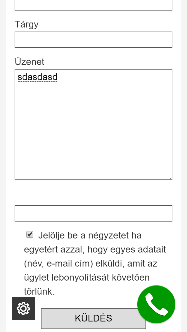

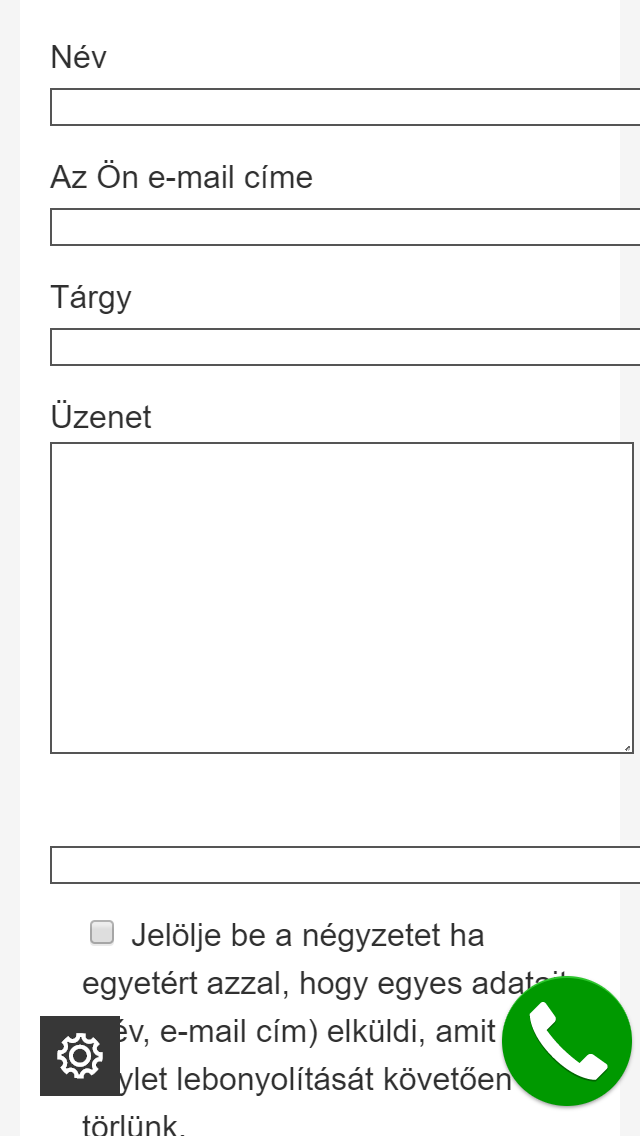

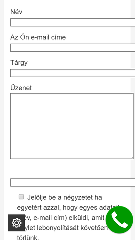

Mobilon a formotok nem teljesen van a helyén:
Fixelhető, ilyesmire:
input[type="text"],
input[type="email"],
textarea {
max-width: 100%;
box-sizing: border-box;
font-size: inherit;
font-family: inherit;
font-style: inherit;
font-weight: inherit;
padding: .25em;
input[type="submit"] {
padding: .5em;
width: 180px;
margin: 1em auto;
display: block;
text-transform: uppercase;
#57018880
