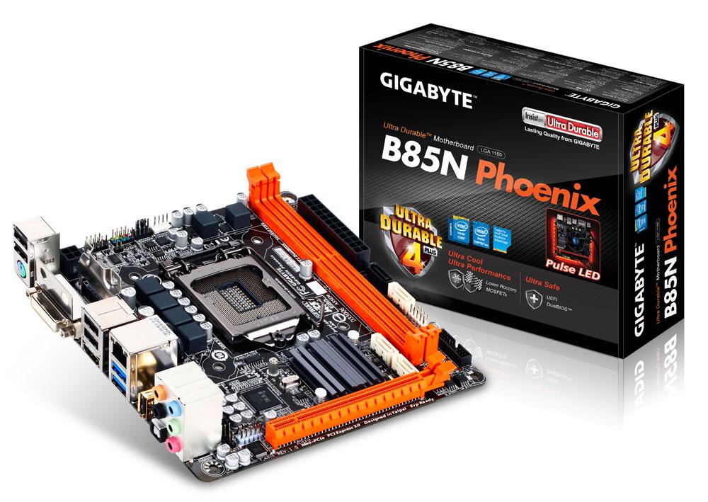

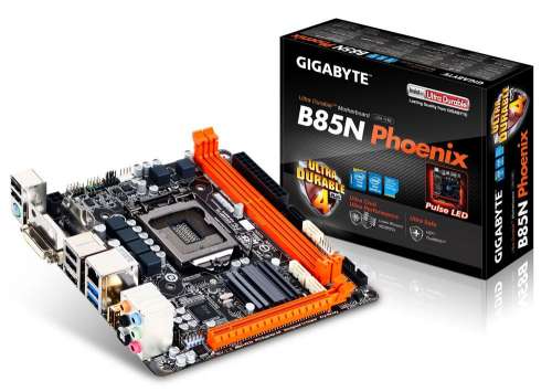

Gigabyte B85N Phoenix hivatalos oldal - [link]
"The GIGABYTE GA-B85N Phoenix is equipped with exclusive Pulse LED lighting on the underside of the PCB, providing a signature look for any custom PC build. The soft-glowing orange lighting elegantly phases in and out during system operation, bringing to life the GIGABYTE B85N Phoenix. Controllable through BIOS, users have 3 options including "Always On", "Off" or "Pulse" mode."
