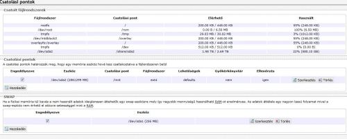

Van labelja, MNT
Ha átnevezem pl WD-re, akkor kell utána valamit módosítanom a mount point-nál kézzel?Amúgy ez most a pen (sda):
Disk /dev/sda: 245 MiB, 256900608 bytes, 501759 sectors
Units: sectors of 1 * 512 = 512 bytes
Sector size (logical/physical): 512 bytes / 512 bytes
I/O size (minimum/optimal): 512 bytes / 512 bytes
Disklabel type: dos
Disk identifier: 0xd77ac499
Device Boot Start End Blocks Id System
/dev/sda1 2048 133119 65536 82 Linux swap / Solaris
/dev/sda2 133120 395263 131072 83 Linux
/dev/sda3 395264 501758 53247+ 83 Linux/dev/sda2 mounted to / as ext4
/dev/sda3 mounted to /mnt as ext4
/dev/sda1 mounted as swap partitionEz pedig a külső hdd (sdb):
Disk /dev/sdb: 1.4 TiB, 1500299395072 bytes, 2930272256 sectors
Disklabel type: dos
Disk identifier: 0xc52df4e2
/dev/sdb1 2048 133119 65536 82 Linux swap / Solaris
/dev/sdb2 133120 395263 131072 83 Linux
/dev/sdb3 395264 2930272255 1464938496 83 Linux/dev/sdb2 mounted to /share/extroot as ext4
/dev/sdb3 mounted to /share/sdb3 as ext4
/dev/sdb1 mounted as swap partitionEzek meg a share-ek
config sambashare
option path '/share'
option read_only 'no'
option guest_ok 'yes'
option create_mask '0777'
option dir_mask '0777'
option name 'share'
config sambashare
option name 'mnt'
option path '/share/sdb3'
option dir_mask '0777' -
