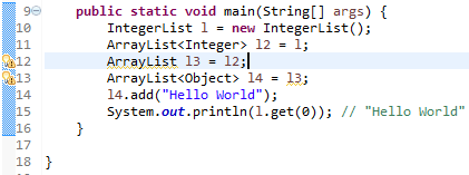

WonderCSabo
12.sor : ArrayList is a raw type. References to generic type ArrayList<E> should be parameterized
13. sor: Type safety: The expression of type ArrayList needs unchecked conversion to conform to ArrayList<Object>Javac meg ezt mondja:
[WARNING] Test/src/Main.java:[12,17] found raw type: java.util.ArrayList
missing type arguments for generic class java.util.ArrayList<E>
[WARNING] Test/src/Main.java:[13,40] unchecked conversion
required: java.util.ArrayList<java.lang.Object>
found: java.util.ArrayList -
