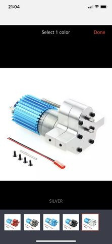

Sziasztok! Ebből hogy derül ki hogy brushead vagy brushess motor?
Metal Transmission Gearbox 370 Motor for WPL 1/16 RC Car B14 B16 B24 B36 C14 C24 JJRC Q60 Q61 Speed Change upgrade spare parts
Features:
1. Precision CNC machining aluminum alloy motor heatsink has better heat dissipation effect.
2. High quality aluminum alloy motor mount base is solid and durable.
3. Anodizing treatment for heatsink and mount base, exquisite in appearance.
4. It is easy and convenient to install and remove.
5. Suitable for WPL 1633 remote control car.
