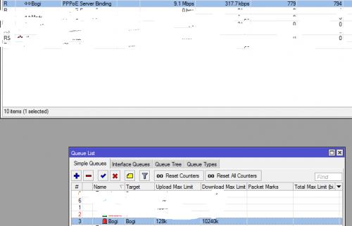

Most vettem észre amúgy, de letöltésben tök faszán nem megy túl, de mint láttad feltöltésben a 128k kétszerese volt valamiért!
Flags: X - disabled, I - invalid, D - dynamic
0 name="Total" target=Bogi,F,Cs,O parent=none packet-marks=""
priority=8/8 queue=ethernet-default/ethernet-default limit-at=0/0
max-limit=8192k/81920k burst-limit=0/0 burst-threshold=0/0
burst-time=0s/0s1 name="F" target=F parent=Total packet-marks="" priority=8/8
queue=default/default limit-at=0/0 max-limit=4096k/81440k burst-limit=0/0
burst-threshold=0/0 burst-time=0s/0s2 I name="Cs" target=Cs parent=Total packet-marks="" priority=8/8
max-limit=4096k/40960k burst-limit=0/0 burst-threshold=0/0
burst-time=0s/0s3 name="Bogi" target=Bogi parent=Total packet-marks="" priority=8/8
max-limit=128k/10240k burst-limit=0/0 burst-threshold=0/0
burst-time=0s/0s4 name="M" target=M parent=none packet-marks="" priority=8/8
max-limit=512k/30720k burst-limit=0/0 burst-threshold=0/0
burst-time=0s/0s5 name="Torrent" target=172.16.20.125/32 parent=none packet-marks=""
max-limit=16M/0 burst-limit=0/0 burst-threshold=0/0 burst-time=0s/0s
time=10h-22h,sun,mon,tue,wed,thu,fri,sat6 name="O" target=O parent=Total packet-marks="" priority=8/8
max-limit=512k/12240k burst-limit=0/0 burst-threshold=0/0
burst-time=0s/0s -
