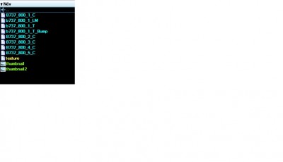

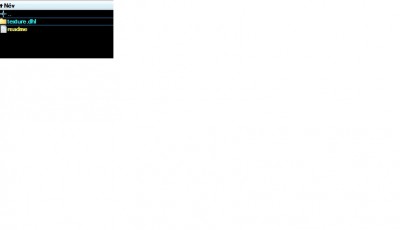

GrooveHero
Gizmo94 #7787 üzenetére
cg-m nincs, de a cfg-t már kitöröltem, pill, és már kapod is
ez itt a readme:
HOW TO INSTALL:
copy all "texture.bg...." folder into your MFSX Airplane B737-800 folder
(c:\.......\Microsoft Flight Simulator X\SimObjects\Airplanes\B737-800)add text below to your B737-800 aircraft.cfg
XX - dont forgot to change it[fltsim.XX]
title=Boeing 737-800 DHL Cargo
sim=Boeing737-800
model=
panel=
sound=
texture=dhl
kb_checklists=Boeing737-800_check
kb_reference=Boeing737-800_ref
atc_id=
atc_airline="DHL"
atc_flight_number="249"
ui_manufacturer="Boeing"
ui_type="737-800"
ui_variation="DHL"
ui_typerole="Cargo"
ui_createdby="Microsoft Corporation"
description="One should hardly be surprised that the world's most prolific manufacturer of commercial aircraft is also the producer of the world's most popular jetliner. The 737 became the best-selling commercial jetliner worldwide when orders for it hit 1,831 in June 1987 (surpassing Boeing's own 727 as the previous champ). However, it wasn't always that way\s in the first few years of production, there were so few orders that Boeing considered canceling the program. They didn't, and the airplane has more than proven itself in over three decades of service."ez meg itt az egész cfg:
