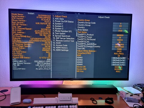

Nekem is van 2 zöld alpixel hibám, viszont ettől eltekintve a panelem jó és 99% nem is látom őket, pedig 1 méterre ülök kb. Szóval, ha jó a panel, akkor én nem cseréltetném, ha esetleg később valami baja lesz, akkor cserélik úgy is egyben az egészet.
Amúgy jött új firmware 03.23.15 verzióval, lehet javítás lesz sokaknak, akik várták.
Ezek változtak:
3. Changes ⓐ HDMI4 no signal improvement (03.00.35) ⓑ Improved HDMI No signal issue in eARC On state (03.00.45) ⓒ Some bug fixes (03.00.60) - in a particular set-top connected to improving not power down -Airplay improved app when the transmission of video in the iPhone TV noise -low volume, the set-top box (1-2) setting improved volume attenuated symptoms - Screen Saver execution error improvement - Improvement of pop-up message that Bluetooth service needs to be initialized ⓓ New model name added_OLED55_65_77CXFNA ⓔ Specific eARC equipment works as ARC improvement (03.00.70) ⓔ Voice mode, output mode, improvement of lip sync distortion when using the voice recognition button on the magic remote control / improvement of no video when switching IP channels (03.00.75) ⓖ Function correspondence (03.10.43) Improved Apple Airplay function
AMD FreeSync support (only OLED CX and GX supported) Improved sports alert function ⓗ Improvement of the issue of icons and text not being displayed properly or being output in a block shape (03.11.10) ⓘ New NVIDIA GeForce RTX 30 series compatibility issues improved (03.11.25) ⓙ HDMI 2.1 compatibility issue improvement (03.11.30) → Improved VRR performance so that there is no interruption in PC and console games ⓚ MR Minor 2 compatible (03.21.09) - Improved home launcher design - Listen to TV sound on mobile through ThinQ App - Added number keys/color keys for screen remote control according to the development of new magic remote control ⓛ Image quality improvement reflected (03.21.16) ⓜ Improvement of minor issues related to software (03.21.21) ⓝ Improvement of minor issues related to software (03.23.10) ⓞ Improvement of minor issues related to software (03.23.15) -
