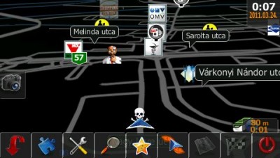

v.0.6 24.03.2011
1. Added street labels toggle switching in 2D and 3D navigation and simulation maps.
2. Changed arrival time tracking. Now displayed time difference +/- from initial calculated time.
3. Technical repairs. -
