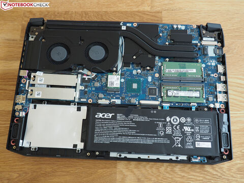

[notebookcheck] teszt. Engem a hűtése nem győz meg:
"GPU core temperatures only reached a maximum of 72 °C during our stress test, but the CPU peaked at 94 °C, which is only a few degrees short of its maximum operating temperature. However, we designed our combined FurMark and Prime95 stress test to push systems to their limits, so you should not experience these high internal temperatures even when enjoying prolonged gaming sessions."
