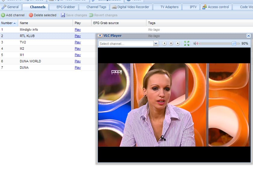

doberman
SteveBeard #35008 üzenetére
amanóba... ennyire érzékeny ez a stick a térerőre? antennát kell fabrikálnom, a hozzáadott kevésnek bizonyult...
viszont van itt egy kis probléma (amit én a térerő hiányára írok) :
Nov 30 06:48:27 Donimo daemon.err tvheadend[9559]: HTTP: 192.168.64.160: /static/extjs/ext-all.js -- 500
Nov 30 06:48:27 Donimo daemon.err tvheadend[9559]: webui: failed to open src/webui/static/extjs/adapter/ext/ext-base.js
Nov 30 06:48:27 Donimo daemon.err tvheadend[9559]: HTTP: 192.168.64.160: /static/extjs/adapter/ext/ext-base.js -- 500
Nov 30 06:48:27 Donimo daemon.err tvheadend[9559]: webui: failed to open src/webui/static/extjs/resources/css/ext-all.css
Nov 30 06:48:27 Donimo daemon.err tvheadend[9559]: HTTP: 192.168.64.160: /static/extjs/resources/css/ext-all.css -- 500
Nov 30 06:48:27 Donimo daemon.err tvheadend[9559]: webui: failed to open src/webui/static/app/extensions.js
Nov 30 06:48:27 Donimo daemon.err tvheadend[9559]: HTTP: 192.168.64.160: /static/app/extensions.js -- 500
Nov 30 06:48:29 Donimo daemon.warn tvheadend[9559]: TS: ITE 9135 Generic_1/826,000 kHz/TV2: Transport error indicator, 9 duplicate log lines suppressed
Nov 30 06:48:29 Donimo daemon.warn tvheadend[9559]: TS: ITE 9135 Generic_1/826,000 kHz/TV2: H264 @ #2011: Continuity counter error, 4 duplicate log lines suppressed
Nov 30 06:48:29 Donimo daemon.warn tvheadend[9559]: TS: ITE 9135 Generic_1/826,000 kHz/TV2: TELETEXT @ #2013: Continuity counter error
Nov 30 06:48:31 Donimo daemon.warn tvheadend[9559]: TS: ITE 9135 Generic_1/826,000 kHz/TV2: Transport error indicator, 10 duplicate log lines suppressed
Nov 30 06:48:33 Donimo daemon.warn tvheadend[9559]: TS: ITE 9135 Generic_1/826,000 kHz/TV2: Transport error indicator, 11 duplicate log lines suppressed
Nov 30 06:48:42 Donimo daemon.warn tvheadend[9559]: TS: ITE 9135 Generic_1/826,000 kHz/TV2: Transport error indicator, 12 duplicate log lines suppressed
Nov 30 06:48:47 Donimo daemon.warn tvheadend[9559]: TS: ITE 9135 Generic_1/826,000 kHz/TV2: H264 @ #2011: Continuity counter error
Nov 30 06:48:49 Donimo daemon.warn tvheadend[9559]: TS: ITE 9135 Generic_1/826,000 kHz/TV2: Transport error indicator, 14 duplicate log lines suppressed
Nov 30 06:48:49 Donimo daemon.warn tvheadend[9559]: TS: ITE 9135 Generic_1/826,000 kHz/TV2: H264 @ #2011: Continuity counter error, 1 duplicate log lines suppressed
Nov 30 06:48:51 Donimo daemon.warn tvheadend[9559]: TS: ITE 9135 Generic_1/826,000 kHz/TV2: Transport error indicator, 16 duplicate log lines suppressed
Nov 30 06:48:51 Donimo daemon.warn tvheadend[9559]: TS: ITE 9135 Generic_1/826,000 kHz/TV2: TELETEXT @ #2013: Continuity counter error
Nov 30 06:48:52 Donimo daemon.warn tvheadend[9559]: TS: ITE 9135 Generic_1/826,000 kHz/TV2: H264 @ #2011: Continuity counter error, 2 duplicate log lines suppressed
Nov 30 06:48:56 Donimo daemon.warn tvheadend[9559]: TS: ITE 9135 Generic_1/826,000 kHz/TV2: Transport error indicator, 18 duplicate log lines suppressed
Nov 30 06:49:07 Donimo daemon.warn tvheadend[9559]: TS: ITE 9135 Generic_1/826,000 kHz/TV2: Transport error indicator
Nov 30 06:49:07 Donimo daemon.warn tvheadend[9559]: TS: ITE 9135 Generic_1/826,000 kHz/TV2: H264 @ #2011: Continuity counter error
Nov 30 06:49:09 Donimo daemon.info hostapd: wlan0: STA 20:7c:8f:2d:7f:ac WPA: group key handshake completed (RSN)
Nov 30 06:49:24 Donimo daemon.warn tvheadend[9559]: TS: ITE 9135 Generic_1/826,000 kHz/TV2: Transport error indicator
Nov 30 06:49:24 Donimo daemon.warn tvheadend[9559]: TS: ITE 9135 Generic_1/826,000 kHz/TV2: H264 @ #2011: Continuity counter error
Nov 30 06:49:24 Donimo daemon.warn tvheadend[9559]: TS: ITE 9135 Generic_1/826,000 kHz/TV2: AAC @ #2012: Continuity counter error
Nov 30 06:49:37 Donimo daemon.warn tvheadend[9559]: TS: ITE 9135 Generic_1/826,000 kHz/TV2: H264 @ #2011: Continuity counter error
Nov 30 06:49:37 Donimo daemon.warn tvheadend[9559]: TS: ITE 9135 Generic_1/826,000 kHz/TV2: AAC @ #2012: Continuity counter error
Nov 30 06:49:41 Donimo daemon.info tvheadend[9559]: capmt: Removing CAPMT Server from service

Egyébként, ha hozzáadsz egy új csatornát, és ott kattintasz a play-re, akkor azt kis ablakban játsza le és úgy sokkal stabilabb. nekem így egyszerre két csatornát is le tudott játszani.
Lehet beállítási probléma, de néha újra kell indítanom a routeren a progit, és csak akkor lehet nézni az adást.Idő hiányában eddig jutottam...
Kíváncsi vagyok a tapasztalataidra! -
doberman
SteveBeard #34954 üzenetére
áhááá!
na ezen a fülön a Channel name az mindenhol Unnamed. Gondolom ez már gond.
(egyébként kiválasztottam a "helyi" adót - rögtön az első hu-békéscsaba, meg is találja mind a 3 mux-ot
és azt írja rá a zöld mezőben, hogy good. ja megleltem a log ablakocskát is ott írta, hogy a scan lefutott...)
Igazából el kell érnem, hogy az adott csatorna neve automatikusan kiíródjon?vargalex v1.1.5 r33777
