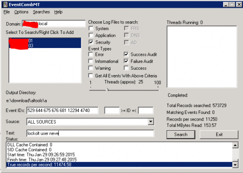

Köszi, ezt végig zongoráztam, de nem talált semmit
Total Bytes Read ending with the Security log on server1: 78928192
e:\download\altools\a\server1-Security_LOG.txt contains no parsed events.
Total Bytes Read ending with the Security log on server2: 74599620
e:\download\altools\a\server2-Security_LOG.txt contains no parsed events. -
