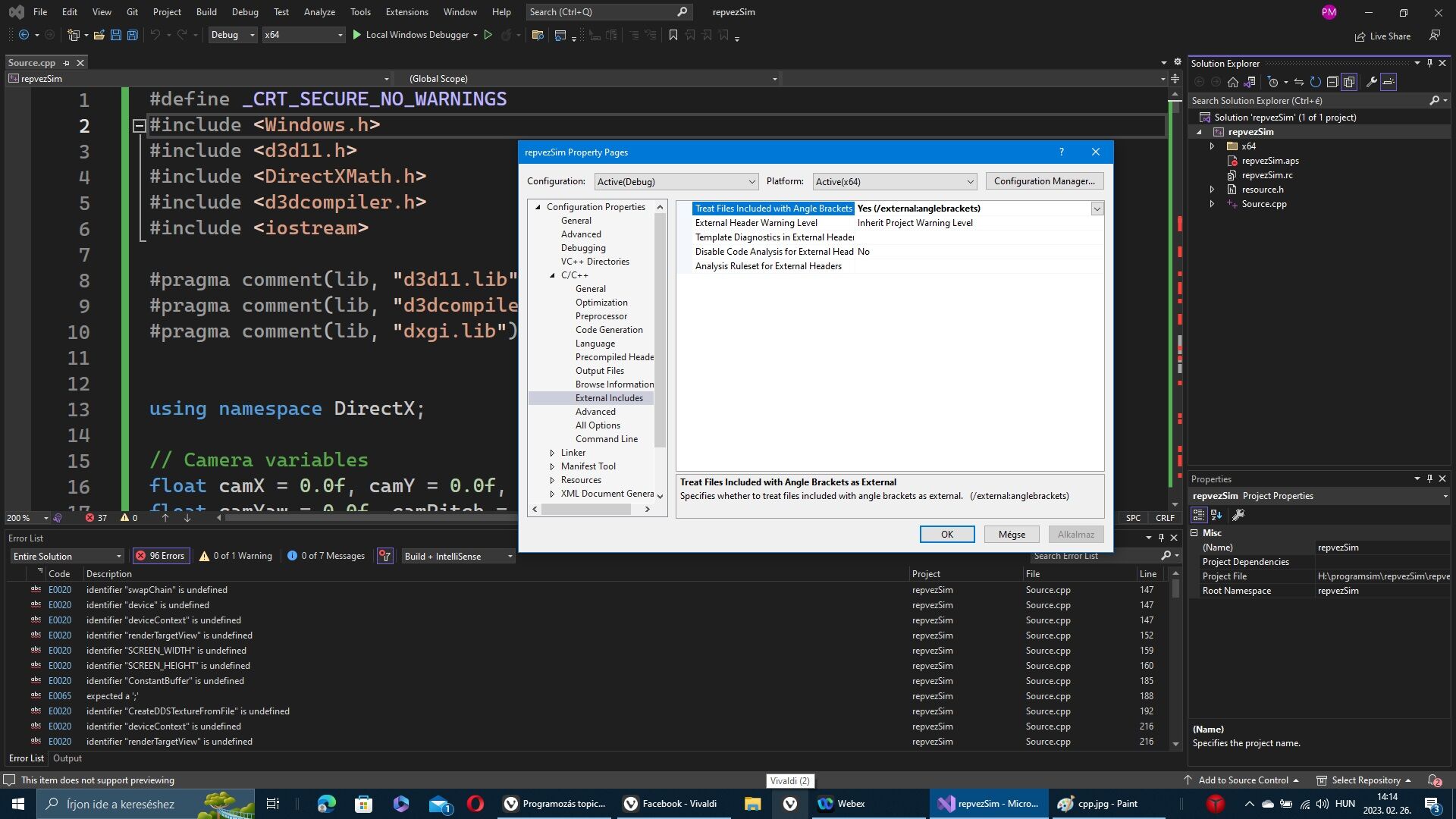

hát a moricka modszer nem jött be, mert hiába commenteltem át az egészet akkor meg azt irja, ki, hogy nincs rendesen lezárva a kod attol a sortol kezdve az utolsoig ahova a comment jelet tettem.
Az alábbi dolgokat megprobáltam megcsinálni, de nem találtam meg, hogy mit hova kéne másolni .
the "undefined reference" errors you are seeing are linker errors, which occur when the linker is unable to find a definition for a symbol that is used in the code. In this case, it means that you are missing some libraries that are needed to link your program.
To resolve these errors, you need to make sure that you are linking against the appropriate libraries. Here are some steps you can take to fix the issue:
Make sure that you have included the correct header files in your code. The header files are used by the compiler to resolve function signatures and other symbols.
Make sure that you have added the required libraries to your linker settings. The libraries are used by the linker to resolve the definitions of the functions and symbols used in your code.
In this case, since you are using DirectX, you need to link against the DirectX libraries. To do this, you can add the following linker directives to your project:
#pragma comment(lib, "dxgi.lib")
#pragma comment(lib, "d3d11.lib")
#pragma comment(lib, "d3dcompiler.lib")these directives tell the linker to include the
dxgi.lib,d3d11.lib, andd3dcompiler.liblibraries in the build process.
Alternatively, you can add the libraries to your linker settings in your project properties. To do this:
Right-click on your project in the Solution Explorer and select "Properties".In the "Configuration Properties" section, select "Linker" -> "Input".Add the required libraries to the "Additional Dependencies" field.
Make sure to separate the library names with a semicolon (;).
After making these changes, try rebuilding your project and see if the linker errors are resolved. -

megnéztem az outputot , de ami errorokat listáz annak az elérési utja mind a cpp fájhoztartozik vagyis ahova mentve van, de nem találok utalást a h fileokra benne.
biztos, -val van baja,lehet a d3d11.h vagy a lib fájlokkal amiket alább linkeltem.
A moricka modszert hogy gondoltad? mert ha sorrol sorra megyek akkor lehet , hogy azért fog hibát dobni, mert hiányzik valami neki ami majd késöbb van a kodba vagy épp még nem teljes a sintaxis és nem azért mert rossz a include.
vagy rosszul gondolom? 430 soros a kod jelenleg igy nem igazán tudom, hogy ez a modszer hogy működne.
repvez
megcsináltam és 123 errort ir , de abbol kb a 2/3 az ilyen
Error (active) E0020 identifier "device" is undefined
Vagy a declarácioval van gondja esetleg ,hogy valahol vesszöket várna a zárojelek elé mogé stb..Azt irták ,hogy a header filokat kellene rendesen meghivni hozzá, hogy ezek a hibák eltunjenek, de nem tudom, hogy hogyan vagy , hogy ez alapbol miért nem történik meg, ha néhány olyan is van közte ami alap dolog lenne, mint a windows.h és az iostream stb...
repvez
full kezdő vagyok, ha megmondod, hol találom amit át kell állitani akkor talán megtalálom, hogy mit ir, de nem vagyok biztos benne, hogy az nekem bármit is jelentene, hogy hogy tudnám megoldani .

elsőre, a 19 azért volt, mert mikor feltelepitettem még nem volt 22-es verzio. másodsorban meg ugy gondoltam, hogy kezdésként az is böven elég ahhoz amire kellene nekem .
DE ma letöröltem mindent és feltettem a 22est az általad megjelölt modulokkal .
Most egy két progi mukodik ,de egy még mindig hiányol dolgokat .
annak a elso soraiban ezek szerepelnek#define _CRT_SECURE_NO_WARNINGS
#include <Windows.h>
#include <d3d11.h>
#include <DirectXMath.h>
#include <d3dcompiler.h>
#include <iostream>
#pragma comment(lib, "d3dcompiler.lib")#include <TopoDS.hxx>
#include <BRepBuilderAPI_MakeEdge.hxx>
#include <BRepBuilderAPI_MakeWire.hxx>
#include <BRepBuilderAPI_MakeFace.hxx>Ezeket hogy tudnám beállitani, hogy ne kapjak rájuk hibaüzenetet, hogy undefined?
repvez
tudna nekem valaki segiteni, hogy mit honnan hogyan kellene letölteni telepiteni vagy beálitani ahhoz, hogy c++ és directX11 es kodok leforduljanak visual studio 2019 alatt?
Feltelepitettem az uj project résznél kiválasztottam a c++ és game opciokat, de valamiért még egy egyszerü kodnál is már hibát dob amikor le akarom forditatni.
Egy hello wordnél is az első sorban az include ra is hibát dob.
A kodra amit használni akarok meg egy como idntified hibát,
windows.h, d3d11.h és lib fájlok is vannak a code-ban.
De nem igazán tudom, hogy még mi hiányzik neki, vagy mit kell beállitnai, hogy müködjön és felismerje ezeket. -
