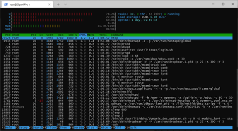

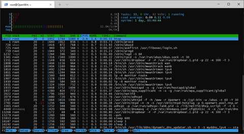

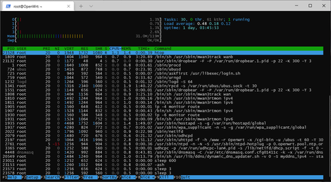

losslessonly
taki01
Az iperf3 szerver egy ubuntu 20.04 szerveren fut a helyi hálón, a kliens meg egy asus rog g14-es laptop a fentebb említett intel ax wifi kártyával.
Kipróbáltam most csak wpa2-vel és a 48-as csatornán:[ ID] Interval Transfer Bandwidth[ 4] 0.00-1.00 sec 33.6 MBytes 281 Mbits/sec[ 4] 1.00-2.00 sec 42.8 MBytes 359 Mbits/sec[ 4] 2.00-3.00 sec 39.2 MBytes 330 Mbits/sec[ 4] 3.00-4.00 sec 40.2 MBytes 337 Mbits/sec[ 4] 4.00-5.00 sec 36.1 MBytes 303 Mbits/sec[ 4] 5.00-6.00 sec 38.9 MBytes 326 Mbits/sec[ 4] 6.00-7.00 sec 37.1 MBytes 311 Mbits/sec[ 4] 7.00-8.00 sec 42.0 MBytes 353 Mbits/sec[ 4] 8.00-9.00 sec 39.0 MBytes 327 Mbits/sec[ 4] 9.00-10.00 sec 39.6 MBytes 332 Mbits/sec- - - - - - - - - - - - - - - - - - - - - - - - -[ ID] Interval Transfer Bandwidth[ 4] 0.00-10.00 sec 389 MBytes 326 Mbits/sec sender[ 4] 0.00-10.00 sec 389 MBytes 326 Mbits/sec receiveriperf Done.Most javult egy kicsit.
vargalex
taki01
Wifi config:
root@OpenWrt:~# cat /etc/config/wirelessconfig wifi-device 'radio0'option type 'mac80211'option path '1e140000.pcie/pci0000:00/0000:00:00.0/0000:01:00.0'option band '5g'option htmode 'VHT80'option cell_density '0'option channel '100'option country 'HU'config wifi-iface 'default_radio0'option device 'radio0'option network 'lan'option mode 'ap'option ssid 'ssid_5GHz'option hidden '1'option encryption 'sae-mixed'option key 'password'config wifi-device 'radio1'option type 'mac80211'option path '1e140000.pcie/pci0000:00/0000:00:01.0/0000:02:00.0'option band '2g'option cell_density '0'option htmode 'HT40'option channel '11'config wifi-iface 'default_radio1'option device 'radio1'option network 'lan'option mode 'ap'option ssid 'ssid'option hidden '1'option encryption 'sae-mixed'option key 'password'Network config:
root@OpenWrt:~# cat /etc/config/networkconfig interface 'loopback'option device 'lo'option proto 'static'option ipaddr '127.0.0.1'option netmask '255.0.0.0'config globals 'globals'option packet_steering '1'option ula_prefix 'fdb3:2b8b:97b7::/48'config deviceoption name 'br-lan'option type 'bridge'list ports 'lan1'list ports 'lan2'list ports 'lan3'option ipv6 '0'config deviceoption name 'lan1'option macaddr '90:8d:78:23:a7:d0'config deviceoption name 'lan2'option macaddr '90:8d:78:23:a7:d0'config deviceoption name 'lan3'option macaddr '90:8d:78:23:a7:d0'config deviceoption name 'lan4'option macaddr '0a:55:50:34:3f:88'option ipv6 '0'config interface 'lan'option device 'br-lan'option proto 'static'option ipaddr '192.168.1.1'option netmask '255.255.255.0'option ip6assign '60'config deviceoption name 'wan'option macaddr '90:8d:78:23:a7:d3'option ipv6 '0'config interface 'wan'option device 'wan'option proto 'static'option ipaddr '192.168.0.200'option netmask '255.255.255.0'option gateway '192.168.0.1'option broadcast '192.168.0.255'list dns '208.67.222.222'list dns '84.2.44.4'list dns '208.67.220.220'list dns '84.2.44.1'list dns '8.8.8.8'option metric '10'option force_link '0'config interface 'wan6'option device 'wan'option proto 'dhcpv6'option auto '0'option reqaddress 'try'option reqprefix 'auto'config interface 'wanb'option proto 'dhcp'option device 'lan4'option metric '20'option delegate '0'option peerdns '0'list dns '8.8.8.8'list dns '8.8.4.4'list dns '1.1.1.1'Iperf3 mérés wifi:
[ ID] Interval Transfer Bandwidth[ 4] 0.00-1.00 sec 35.8 MBytes 299 Mbits/sec[ 4] 1.00-2.00 sec 34.4 MBytes 288 Mbits/sec[ 4] 2.00-3.00 sec 30.9 MBytes 258 Mbits/sec[ 4] 3.00-4.00 sec 36.1 MBytes 303 Mbits/sec[ 4] 4.00-5.00 sec 36.0 MBytes 302 Mbits/sec[ 4] 5.00-6.00 sec 34.9 MBytes 293 Mbits/sec[ 4] 6.00-7.00 sec 35.1 MBytes 294 Mbits/sec[ 4] 7.00-8.00 sec 34.6 MBytes 291 Mbits/sec[ 4] 8.00-9.00 sec 36.1 MBytes 303 Mbits/sec[ 4] 9.00-10.00 sec 36.6 MBytes 307 Mbits/sec- - - - - - - - - - - - - - - - - - - - - - - - -[ ID] Interval Transfer Bandwidth[ 4] 0.00-10.00 sec 350 MBytes 294 Mbits/sec sender[ 4] 0.00-10.00 sec 350 MBytes 294 Mbits/sec receiveriperf Done.
Kábeles teszt:[ ID] Interval Transfer Bandwidth[ 4] 0.00-1.00 sec 113 MBytes 950 Mbits/sec[ 4] 1.00-2.00 sec 113 MBytes 949 Mbits/sec[ 4] 2.00-3.00 sec 113 MBytes 948 Mbits/sec[ 4] 3.00-4.00 sec 112 MBytes 942 Mbits/sec[ 4] 4.00-5.00 sec 113 MBytes 949 Mbits/sec[ 4] 5.00-6.00 sec 113 MBytes 949 Mbits/sec[ 4] 6.00-7.00 sec 113 MBytes 947 Mbits/sec[ 4] 7.00-8.00 sec 113 MBytes 949 Mbits/sec[ 4] 8.00-9.00 sec 113 MBytes 948 Mbits/sec[ 4] 9.00-10.00 sec 113 MBytes 949 Mbits/sec- - - - - - - - - - - - - - - - - - - - - - - - -[ ID] Interval Transfer Bandwidth[ 4] 0.00-10.00 sec 1.10 GBytes 948 Mbits/sec sender[ 4] 0.00-10.00 sec 1.10 GBytes 948 Mbits/sec receiveriperf Done. -
vargalex
taki01
taki01
vargalex
taki01
vargalex
taki01
Samsung Galaxy S21 és egy Asus laptoppal amiben intel ax 200 160MHz. Openwrt 21.02.2 és be van kapcsolva HW offload. Pár extra csomag van fent: mwan3 és ddns_scripts plusz a hozzájuk tartozó luci-s csomagok. Wifi-s konfigban nem állítottam át semmit, csak elrejtettem az ssid-t és beállítottam a wpa2/wpa3 psk titkosítást.
Kipróbáltam a 19.07.8-t is, de az folyamatosan random újraindult. -
