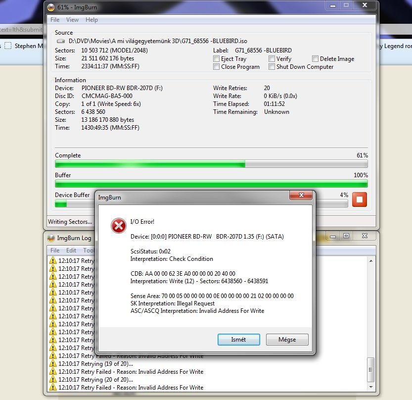

Nos megjött a friss Verba lemez, rögtön az elsőnél el is szállt az írás
Ennyit az új lemezről.
I 12:00:46 ImgBurn Version 2.5.8.0 started!
I 12:00:46 Microsoft Windows 7 Ultimate x64 Edition (6.1, Build 7601 : Service Pack 1)
I 12:00:46 Total Physical Memory: 4 140 152 KiB - Available: 2 962 636 KiB
I 12:00:46 Initialising SPTI...
I 12:00:46 Searching for SCSI / ATAPI devices...
E 12:00:46 Failed to check for ImgBurn update!
I 12:00:47 -> Drive 1 - Info: PIONEER BD-RW BDR-207D 1.35-ID61 (F(SATA)
I 12:00:47 Found 1 BD-RE!
I 12:01:24 Operation Started!
I 12:01:24 Source File: D:\DVD\Movies\A mi világegyetemünk 3D\G71_68556 -BLUEBIRD.iso
I 12:01:24 Source File Sectors: 10 503 712 (MODE1/2048)
I 12:01:24 Source File Size: 21 511 602 176 bytes
I 12:01:24 Source File Volume Identifier: G71_68556 -BLUEBIRD
I 12:01:24 Source File Volume Set Identifier: 8D078607D2EF73A3_VOLUME_SET_ID
I 12:01:24 Source File Application Identifier: APPLICATION_ID
I 12:01:24 Source File Implementation Identifier: IMPLEMENTATION_ID
I 12:01:24 Source File File System(s): UDF (2.50)
I 12:01:24 Destination Device: [0:0:0] PIONEER BD-RW BDR-207D 1.35 (F(SATA)
I 12:01:24 Destination Media Type: BD-R (Disc ID: CMCMAG-BA5-000)
I 12:01:24 Destination Media Supported Write Speeds: 2x; 4x; 6x; 8x; 10x; 12x
I 12:01:24 Destination Media Sectors: 12 219 392
I 12:01:24 Write Mode: BD
I 12:01:24 Write Type: DAO
I 12:01:24 Write Speed: 6x
I 12:01:24 Hardware Defect Management Active: No
I 12:01:24 BD-R Verify Not Required: Yes
I 12:01:24 Link Size: Auto
I 12:01:24 Lock Volume: Yes
I 12:01:24 Test Mode: No
I 12:01:24 OPC: No
I 12:01:24 BURN-Proof: Enabled
I 12:01:24 Write Speed Successfully Set! - Effective: 26 970 KB/s (6x)
I 12:01:24 Advanced Settings - Optimal Writing Speed: No
I 12:01:25 Filling Buffer... (80 MiB)
I 12:01:25 Writing LeadIn...
I 12:01:41 Writing Session 1 of 1... (1 Track, LBA: 0 - 10503711)
I 12:01:41 Writing Track 1 of 1... (MODE1/2048, LBA: 0 - 10503711)
W 12:10:16 Failed to Write Sectors 6438560 - 6438591 - Reason: Invalid Address For Write
W 12:10:17 Retrying (1 of 20)...
W 12:10:17 Retry Failed - Reason: Invalid Address For Write
W 12:10:17 Retrying (2 of 20)...
W 12:10:17 Retrying (3 of 20)...
E 13:13:24 Failed to Write Sectors 6438560 - 6438591 - Reason: Invalid Address For Write
E 13:13:24 Next Writable Address: 6436832
I 13:13:24 Synchronising Cache...
W 13:13:26 User opted to skip the 'Close Track/Session/Disc' functions.
E 13:13:26 Failed to Write Image!
I 13:13:26 Exporting Graph Data... -
Zolik
Köszi a tippet! 10es packet vettem, direkt kipróbálásra. Még van 4db lemez, nem fogok az eladóval vitatkozni, úgyis jön a "biztos a géped szar/szar az iró progi/szar az író kifogás. De legközelebb erre figyelek.
3 márkát láttam eddig, ez a tdk, maxell és verbatim. Az első kettő ugye ritek, verba-ról tudsz valamit esetleg? -
Zolik
Az a trágya ritek lemez TDK BD-R 25-ös lemez. (nyilván nincs rajta egyiken sem, hogy milyen alapanyag)
Az írási sebességet azért tettem max-ra mert 4x-es írási módban már rögtön, 1%nál hibával elszállít az írás. Utána meg megírta. Azt meg tényleg nem értem ha 4x-es max a lemez hogy lehet hogy engedi 10x-en írni?
Előtte Maxell-t vettem, de ha jól tudom az is ritek alapanyag.
Mit javasoltok? -
