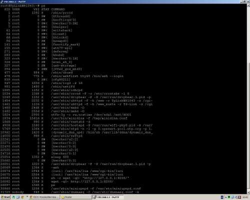

root@TpLink1043:~# free
total used free shared buffers
Mem: 61344 41720 19624 0 5072
-/+ buffers: 36648 24696 -
