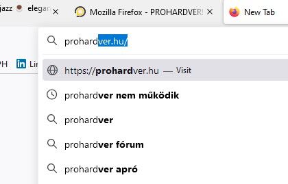

A manóba, tényleg nem működik nálam sem.
Ezt találtam még, de nem tudom működik-e, internet people szerint igen:
"...Open about:config and find the pref toolkit.legacyUserProfileCustomizations.stylesheets and make it true.
Open your profile folder. Use about:support if that makes it easier.
Close Firefox.
Create a directory /chrome in your profile directory if it does not exist.
Create a new text file to be saved as userChrome.css in that directory.
Paste this in the file and save it:#urlbar-results { display:none; }
restart teh Firefox..." -
