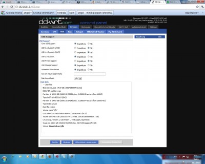

bpmcwap
bpmcwap #13277 üzenetére
már leformáztam de semmi...
dmesg:<6>[ 5.750000] usb 1-1.4: new high speed USB device using ar71xx-ehci and address 4
<6>[ 5.880000] scsi0 : usb-storage 1-1.4:1.0
<6>[ 5.990000] usbcore: registered new interface driver usblp
<5>[ 6.890000] scsi 0:0:0:0: Direct-Access Generic External 2.10 PQ: 0 ANSI: 4
<5>[ 6.900000] sd 0:0:0:0: [sda] 976773168 512-byte logical blocks: (500 GB/465 GiB)
<5>[ 6.910000] sd 0:0:0:0: [sda] Write Protect is off
<7>[ 6.910000] sd 0:0:0:0: [sda] Mode Sense: 21 00 00 00
<3>[ 6.910000] sd 0:0:0:0: [sda] Assuming drive cache: write through
<3>[ 6.920000] sd 0:0:0:0: [sda] Assuming drive cache: write through
<6>[ 6.930000] sda: sda1 sda2 sda3
<3>[ 6.950000] sd 0:0:0:0: [sda] Assuming drive cache: write through
<5>[ 6.960000] sd 0:0:0:0: [sda] Attached SCSI disk
<6>[ 7.710000] device br0 entered promiscuous mode
<6>[ 7.760000] device vlan1 entered promiscuous mode
<6>[ 7.770000] device eth0 entered promiscuous mode
<4>[ 7.990000]
<4>[ 7.990000] ath_numswbaperbc = 8(1)adj=76800
<4>[ 8.630000] EXT2-fs (sda1): warning: mounting unchecked fs, running e2fsck is recommen ded
<6>[ 10.070000] warning: `proftpd' uses 32-bit capabilities (legacy support in use)
<6>[ 11.720000] device ath0 entered promiscuous mode???
