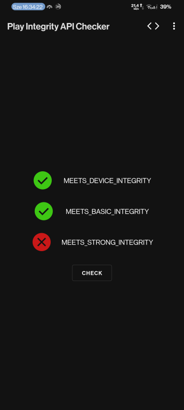

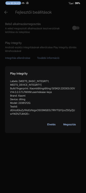

pvt.peter
pvt.peter #5014 üzenetére
Sikerült rájönni basszus.
Korábban detacheltem a Facebook Messenger Lite -ot a j-hc féle zygisk-detach -el.
Íme a log, amikor integrity check fut:[8575] smc.b(11): requestIntegrityToken() failed for com.android.vending.
com.google.android.finsky.integrityservice.IntegrityException: java.lang.IllegalArgumentException: Unknown package: ��om.facebook.mlite
at smc.a(PG:10)
at lid.a(PG:83)
at asgu.run(PG:18)
at java.util.concurrent.ThreadPoolExecutor.runWorker(ThreadPoolExecutor.java:1167)
at java.util.concurrent.ThreadPoolExecutor$Worker.run(ThreadPoolExecutor.java:641)
at mxv.run(PG:385)
at java.lang.Thread.run(Thread.java:919)
Caused by: java.lang.IllegalArgumentException: Unknown package: ��om.facebook.mlite
at android.os.Parcel.createException(Parcel.java:2078)
at android.os.Parcel.readException(Parcel.java:2042)
at android.os.Parcel.readException(Parcel.java:1990)
at android.content.pm.IPackageManager$Stub$Proxy.getInstallerPackageName(IPackageManager.java:6737)
at android.app.ApplicationPackageManager.getInstallerPackageName(ApplicationPackageManager.java:2091)
at szp.apply(PG:1049)
at mrh.accept(PG:78)
at j$.util.stream.f1.accept(SourceFile:4)
at j$.util.Iterator$-EL.forEachRemaining(SourceFile:24)
at j$.util.g0.forEachRemaining(Unknown Source:23)
at j$.util.stream.c.c(SourceFile:21)
at j$.util.stream.c.y(SourceFile:8)
at j$.util.stream.Y0.a(SourceFile:5)
at j$.util.stream.c.f(SourceFile:35)
at j$.util.stream.z1.collect(SourceFile:83)
at slb.a(PG:109)
at ooy.apply(PG:600)
at asfn.d(PG:3)
at asfo.run(PG:42)
... 4 more
Caused by: android.os.RemoteException: Remote stack trace:
at com.android.server.pm.Settings.getInstallerPackageNameLPr(Settings.java:4254)
at com.android.server.pm.PackageManagerService.getInstallerPackageName(PackageManagerService.java:22217)
at android.content.pm.IPackageManager$Stub.onTransact(IPackageManager.java:3084)
at com.android.server.pm.PackageManagerService.onTransact(PackageManagerService.java:4112)
at android.os.Binder.execTransactInternal(Binder.java:1021)Tehát egyértelműen a Messenger Lite miatt akad be vmi, gondolom a package installer neve megváltoztatásra került és ez kerül összehasonlításra az eredeti névvel, innen az elszállás.
Mostmár szépen hozza a MEETS_BASIC_INTEGRITY -t és a MEETS_DEVICE_INTEGRITY -t is.
Kellene vmi amivel nem csak detachelni tudom, hanem kitudom venni ebből az ellenőrzésből is a Facebook Messenger Lite -ot. Tudsz erre vmi ötletet crok?
(A detach azért kell nekem ebben az esetben mert korábbi verziót használok az említett alkalmazásból és nem akarom, hogy frissüljön.)Update:
Ahogy látom már van issue róla: Breaks Play Integrity API #18 -
