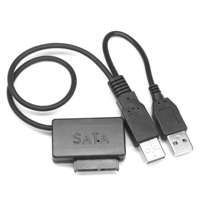

FoxiestFox #85616 üzenetére
Slim sata (ODD) to Sata adapterrel
Vagy eleve Slim Sata (ODD) to USB adapter
