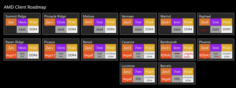

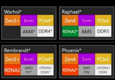

Jajj .. 2022-Q4 ! - akkor az egyik variáció:
2022Q1: ZEN3 XT
2022Q4: ZEN4AMD ZEN4 and RDNA3 architectures both rumored to launch in Q4 2022
https://videocardz.com/newz/amd-zen4-and-rdna3-architectures-both-rumored-to-launch-in-q4-2022 -

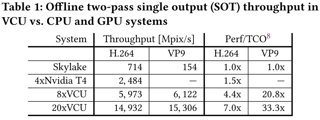

CPU trend: VCPU specializálódás ..
Az általános x86 CPU feladatot - egyre inkább specializált chipek veszik át."Google New Custom Silicon Replaces 10 Million Intel CPUs | Google Argos VPU"
https://semianalysis.substack.com/p/google-new-custom-silicon-replaces
"if we assume that Google’s servers are utilized at 100% (they aren’t), all YouTube/Google Photos/Google Drive footage video is 1080p 30FPS, and the target is H264, the workload would require ~904,000 Intel Skylake server CPUs to encode. Google switching to VP9 with the same set of assumptions would require ~4,193,000 Intel Skylake server CPUs. If the ingest footage is 4k 60FPS, then the number of CPUs required for H264 is ~7,205,000, and VP9 requires ~33,407,000." -

AMD Rembrandt will not get Infinity Cache
AMD has recently updated the Linux kernel with information on the upcoming Yellow Carp APU.
https://videocardz.com/newz/amd-ryzen-6000-rembrandt-yellow-carp-apu-will-reportedly-not-feature-infinity-cache
The APU will require a new FP7 socket, which will force laptop makers to adopt existing designs for new motherboards and possibly power and thermal characteristics of the “Yellow Carp” APU series. This is understandable, as Rembrandt brings major changes not only to the CPU and GPU core but also I/O. Rembrandt will be the first AMD APU to support DDR5 and LPDDR5 memory standards. It will also enable PCIe Gen4 support, which is something that Cezanne currently does not.
According to some new information, Rembrandt will not have Level3 (L3) cache, at least there is no such entry in the recent Linux kernel update (only L1 and L2 cache).
Furthermore, instead of 8 Compute Units per ShaderArray, Rembrandt will have 6. The code does not confirm the full number of CUs in the APU though. The Zen3+ and 6nm fabrication processes have not yet been confirmed either, but they have been repeated in rumors for quite a while, so it would be surprising if they turn out to be false.
Source: @Broly_X1

még egy variáció ..
"AMD Zen 4 Powered Ryzen ‘Raphael’ Desktop CPU Rumors: Over 20% IPC Gain, 16 Core Flagship at Launch, DDR5-5200 on AM5 LGA1718 Socket, 2022 Launch"
Wccftech
( jobb egérklick + új ablakban megnyit és akkor olvasható ) -

Lehet, hogy mégis lesz Warhol ( ZEN3+ )
https://twitter.com/KittyYYuko/status/1396241079913959426GTranslátorral fordítva:
"AMD seems to have resumed the Warhol project, but it's still 7nm on the roadmap. It will be a 6nm process."@1usmus : " Confirm"
A nagy kérdés, hogy mikor jön a ZEN4 .. mert addig is kell valami.
S_x96x_S
mintha az első AM5-ös chipset - nem PCIeGen5 -ös lenne ..
vagy ez még ZEN3+ -os mag ..Lehet, hogy hasonló lesz az átmenet mint az AM4 megjelenésekor, az "A"-s procikkal.
AM5 😏
- LGA-1718
- Dual-channel DDR5
- PCI-e 4.0
- 600 series chipset
https://twitter.com/ExecuFix/status/1396185408904564738----------------------------------------------------------------------------------------------------
-- videocardz-os link:
https://videocardz.com/newz/amd-next-gen-am5-platform-to-feature-lga1718-socket
"PCI Express Gen5 support is to be exclusive to Zen4 Genoa (EPYC) processors. This means that the next-gen AMD consumer processors will retain PCIe Gen4 support. AMD AM5 processors are to compete with Intel Alder Lake-S, which is now confirmed to support PCIe Gen5 interface as well as DDR5." -

"AMD Ryzen 6000 notebook roadmap leaks, 6nm Rembrandt with Zen3+ and Navi2 in 2022"
https://videocardz.com/newz/amd-ryzen-6000-notebook-roadmap-leaks-6nm-rembrandt-with-zen3-and-navi2-in-2022"AMD Rembrandt-H will launch in 2022 on the new FP7 socket. The roadmap confirms it would utilize a 6nm fabrication process as well as the new Zen3+ core architecture. These 45W TDP processors are to support PCIe Gen4, LPDDR5, and DDR5 memory as well as USB4. A low power (15W) Rembrandt-U variant is also to be expected featuring identical specifications."

a nemzetközi helyzet fokozódik ..
AMD Rembrandt with Zen3+ and RDNA2
AMD Ryzen 6000 mobile series beginning to leak.
https://videocardz.com/newz/amd-ryzen-9-6900h-rembrandt-rumored-to-feature-zen3-cores-and-12-rdna2-compute-units
"The only Zen3+ that I've seen is the 6nm one in Rembrandt" -

Ha abból indulok ki, hogy
a.) Augusztus ( után valamikor ) ---> új Threadripper
b. ) valamint nézegetve a legújabb Videocardz-os összefoglalót az AMD roadmap-ról. benne egy ilyen megjegyzéssel"The Zen3+ (unofficial name) based processors should launch later this year. We have heard some rumors that both next-gen Threadripper and Ryzen 5000 Refresh (or Ryzen 6000) might use this new node. It may explain the delay of the new Threadripper"
lassú felfogású vagyok ..
és most kezdek rádöbbeni, hogy az agusztusi Threadripper - akár már ZEN3+ ; 6nm -as is lehet ..
és talán akkor szeptemberben jön a hasonló Ryzen 6000-el és az új X570S-es alaplapokkal.( Párhuzamosan az Intel új procijaival. )
vagyis akkor a Zen3+ és 6nm a következő lépés.Persze a 6nm - valószínüleg csak a 7nm picit csiszolt verziója
( amolyan 7nm+ )
mindenesetre talán meglehet a bűvös 5GHz-es határ is.És remélem, hogy a ZEN4 procik első köre a következő év első felében (2022H1) piacra kerülnek ..

Petykemano #4956 üzenetére
> A remrandtól ki van húzva az AM rész.
> Ezért lehet DDR5, de DIY nem lehet majd kapni.jó hogy felhívtad a figyelmemet ..
jobban megnézve a másik chiphell-es ábrát .. ( kivágva alul )
tényleg nincs a Rembrandt*-ból AM4-es.
- AM5(desktop)/FP7(integrált,laptop) van feltüntetve.ha feltételezem,
hogy az oszlopok az időrendi sorrendet is meghatározzák,
akkor az első körben (idén?) a Gen4/DDR5 -ös AM5 -ök jönnek ki.

pletyka .. 6000, 7000
"Ryzen 6000 would be based on 6000 Rembrandt architecture (Zen 3+) and Barcelo (Zen 3). New is the (apparent) addition of Navi graphics to Raphael, the Zen 4-based Ryzen 7000 desktop chips. According to users on ChipHell, AMD will switch to an I/O die fabricated at 6 nm with this generation. There would be n IGP in every AMD processor. Phoenix, the Ryzen mobile Ryzen 7000 chip, coming to the desktop as well, would contain a stronger, newer graphic piece based on RDNA 3. It is reported that AMD has internally set the target to achieve 50 percent better performance per watt with RDNA 3 compared to RDNA 2. The step to DDR5 memory may mean that this computing power can also be performed well in an APU."
https://www.guru3d.com/news-story/rumor-ryzen-7000-processors-all-get-integrated-graphics.htmlAmi érdekes a táblázatban - és nem tudom, hogy elírás-e.
Ryzen 6000 Warhol Zen 3+ 6 nm ddr4 PCIe4
Ryzen 6000G Rembrandt Zen 3+ 6 nm RDNA2 ddr5 PCIe4vagyis
a 6000G-s már DDR5-öt kap, a 6000X-es meg csak DDR4-et?
Ezt csak úgy tudom elképzelni,
- hogy 3-4 hónappal később jön ki a 6000G-s ;
- vagy az AM4-es DDR5-ös alaplapok hiányával.
vagy ...És az is lehet, hogy a DDR5-re már új chipset is kell ..
elméletileg a memóriavezérlő az i/o die-ban van ..
de kérdéses, hogy a gyakorlatban ez működik-e ..mindenesetre ez felemás válasz az Inteles Gen5/DDR5 -re ..
de majd meglátjuk a valóságban.
