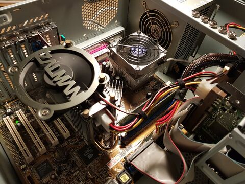

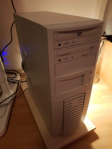

Asus A7N8X Deluxe rev 2.0
AMD Athlon XP 3200+
Spire Falconrock II
Samsung 512M DDR-400
Sapphire Atlantis Radeon 9800 Pro 128M AGP
Zalman ZM80C-HP + ZM-OP1
Creative Sound Blaster Audigy 2 Player SB0240 PCI
Seagate Barracuda 7200.7 120G IDE
LiteOn XJ-HD166S 16x DVD-ROM IDE
LiteOn LTR-52327S 52x32x52x CD-RW IDE
Chieftec Dragon DG-01W
Enermax EG365AX-VE(G) -
