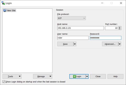

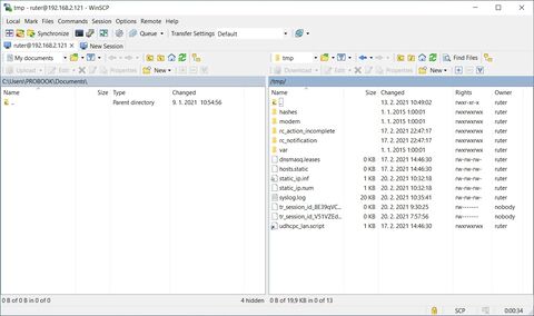

Próbáld ki amit írtam fenntebb. Az egytlen nehézség benne, hogy nem feltétlenül van copy-paste készre csinálva. Ebben azonban segíthetek (IP + token cserélendő) :
(nvram set ssh_en=1;nvram commit)
http://192.168.1.1/cgi-bin/luci/;stok=<EZTCSERELD>/api/misystem/set_config_iotdev?bssid=Xiaomi&user_id=longdike&ssid=-h%3Bnvram%20set%20ssh%5Fen%3D1%3B%20nvram%20commit%3B(sed -i 's/channel=.*/channel="debug"/g' /etc/init.d/dropbear)
http://192.168.1.1/cgi-bin/luci/;stok=<EZTCSERELD>/api/misystem/set_config_iotdev?bssid=Xiaomi&user_id=longdike&ssid=-h%3Bsed%20-i%20's/channel=.*/channel=%5C%22debug%5C%22/g'%20/etc/init.d/dropbear%3B(/etc/init.d/dropbear start)
http://192.168.1.1/cgi-bin/luci/;stok=<EZTCSERELD>/api/misystem/set_config_iotdev?bssid=Xiaomi&user_id=longdike&ssid=-h%3B/etc/init.d/dropbear%20start%3B(root ssh pass change to admin)
http://192.168.1.1/cgi-bin/luci/;stok=<EZTCSERELD>/api/misystem/set_config_iotdev?bssid=Xiaomi&user_id=longdike&ssid=-h%3B%20echo%20-e%20'admin%5Cnadmin'%20%7C%20passwd%20root%3Bhttps://github.com/hanwckf/rt-n56u/releases
scp /AKONYVTARAHOVALETOLTOTTED/RM2100.trx root@192.168.1.1:/tmp
dd if=RM2100.trx bs=4194304 count=1 of=redmi.kernel1.trx
dd if=RM2100.trx bs=4194304 skip=1 of=redmi.rootfs0.trx
mtd write redmi.kernel1.trx kernel1
mtd write redmi.rootfs0.trx rootfsnvram set uart_en=1
nvram set bootdelay=5
# Set kernel1 as the booting kernel
nvram set flag_try_sys1_failed=1
# Commit our nvram changes
nvram commit -
