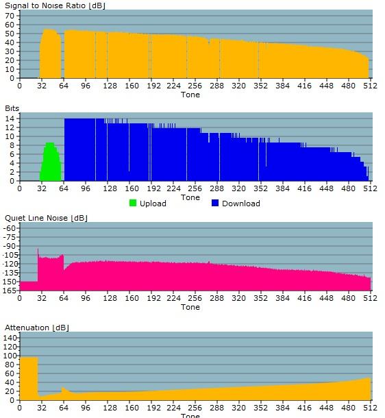

Az a problémám az adsl kapcsolatommal, hogy sűrűn megszakad torrentezés közben. 200%-ra tettem a target snr margint, hátha jobb lesz, de nem igazán. Belinkelem a grafikonokat és az info tartalmát, hátha látszik belőle valami. A tippeket előre is köszönöm!
Status: Showtime
Retrain Reason: 0
Max: Upstream rate = 1432 Kbps, Downstream rate = 17196 Kbps
Path: 0, Upstream rate = 635 Kbps, Downstream rate = 12478 Kbps
Link Power State: L0
Mode: ADSL2+
Trellis: U:ON /D:ON
Line Status: No Defect
Training Status: Showtime
Down Up
SNR (dB): 12.5 27.3
Attn(dB): 21.5 11.9
Pwr(dBm): 0.0 11.8
ADSL2 framing
MSGc: 91 12
B: 36 39
M: 1 1
T: 7 2
R: 10 4
S: 0.0945 1.9887
L: 3978 177
D: 160 8
Counters
SF: 39264461 543649
SFErr: 6 0
RS: 890765256 4207654
RSCorr: 80419 0
RSUnCorr: 44 0
HEC: 5 0
OCD: 0 0
LCD: 0 0
Total Cells: 1360352973 19623
Data Cells: 968503722 15627
Drop Cells: 15111
Bit Errors: 0 0
ES: 5 0
SES: 0 0
UAS: 21 0
AS: 629999
INP: 1.60 0.72
PER: 16.04 17.89
delay: 3.78 3.97
OR: 48.36 8.04
Bitswap: 10022 246483
Total time = 1 days 7 hours 55 sec
SF = 39264461
CRC = 6
LOS = 0
LOF = 0
ES = 5
Latest 1 day time = 7 hours 55 sec
SF = 1574070
CRC = 0
LOS = 0
LOF = 0
ES = 0
Latest 15 minutes time = 55 sec
SF = 3501
CRC = 0
LOS = 0
LOF = 0
ES = 0
Previous 15 minutes time = 15 min 0 sec
SF = 56074
CRC = 0
LOS = 0
LOF = 0
ES = 0
Previous 1 day time = 24 hours 0 sec
SF = 5384841
CRC = 0
LOS = 0
LOF = 0
ES = 0
15 minutes interval [-30 min to -15 min] time = 15 min 0 sec
SF = 56074
CRC = 0
LOS = 0
LOF = 0
ES = 0
15 minutes interval [-45 min to -30 min] time = 15 min 0 sec
SF = 56074
CRC = 0
LOS = 0
LOF = 0
ES = 0
15 minutes interval [-60 min to -45 min] time = 15 min 0 sec
SF = 56136
CRC = 0
LOS = 0
LOF = 0
ES = 0
Showtime Drop Reason: 0
Last Retrain Reason: 0
