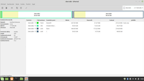

Sziasztok! Még mindig a bárhol (UEFI és Legacy, 32 és 64 bit) bebootolható USB-s eszközre való linux telepítést akarom megoldani erre az eszközre (az első partíció lesz az ESP, a másodikra kerül a 64 bites telepítés, a harmadikra a 32 bites majd UEFI és Legacy körülmények között is Grubbal egymás után telepítgetve):
Ezt alakítgattam át gdisk segítségével hibrid GPT-MBR szerkentyűvé. Jól csináltam eddig?[azenn@azen-pc ~]$ sudo gdisk /dev/sdc
[sudo] azenn jelszava:
GPT fdisk (gdisk) version 1.0.4Partition table scan:
MBR: protective
BSD: not present
APM: not present
GPT: presentFound valid GPT with protective MBR; using GPT.
Command (? for help): r
Recovery/transformation command (? for help): p
Disk /dev/sdc: 1465149166 sectors, 698.6 GiB
Model: Storage Device
Sector size (logical/physical): 512/512 bytes
Disk identifier (GUID): B042A8F4-41B1-483E-B1B2-90936DBD23FF
Partition table holds up to 128 entries
Main partition table begins at sector 2 and ends at sector 33
First usable sector is 34, last usable sector is 1465149132
Partitions will be aligned on 2048-sector boundaries
Total free space is 3755 sectors (1.8 MiB)Number Start (sector) End (sector) Size Code Name
1 2048 1048575 511.0 MiB 0700
2 1048576 734003199 349.5 GiB 8300
3 734003200 1465147391 348.6 GiB 8300Recovery/transformation command (? for help): h
WARNING! Hybrid MBRs are flaky and dangerous! If you decide not to use one,
just hit the Enter key at the below prompt and your MBR partition table will
be untouched.Type from one to three GPT partition numbers, separated by spaces, to be
added to the hybrid MBR, in sequence: 1 2 3
Place EFI GPT (0xEE) partition first in MBR (good for GRUB)? (Y/N): yCreating entry for GPT partition #1 (MBR partition #2)
Enter an MBR hex code (default 07): 0c
Set the bootable flag? (Y/N): yCreating entry for GPT partition #2 (MBR partition #3)
Enter an MBR hex code (default 83): 83
Set the bootable flag? (Y/N): nCreating entry for GPT partition #3 (MBR partition #4)
Set the bootable flag? (Y/N): nRecovery/transformation command (? for help): o
Disk size is 1465149166 sectors (698.6 GiB)
MBR disk identifier: 0x00000000
MBR partitions:Number Boot Start Sector End Sector Status Code
1 1 2047 primary 0xEE
2 * 2048 1048575 primary 0x0C
3 1048576 734003199 primary 0x83
4 734003200 1465147391 primary 0x83Recovery/transformation command (? for help): w
Final checks complete. About to write GPT data. THIS WILL OVERWRITE EXISTING
PARTITIONS!!Do you want to proceed? (Y/N): y
OK; writing new GUID partition table (GPT) to /dev/sdc.
Warning: The kernel is still using the old partition table.
The new table will be used at the next reboot or after you
run partprobe(8) or kpartx(8)
The operation has completed successfully.
[azenn@azen-pc ~]$[azenn@azen-pc ~]$ sudo gdisk /dev/sdc
MBR: hybrid
BSD: not present
APM: not present
GPT: present
Found valid GPT with hybrid MBR; using GPT.
Recovery/transformation command (? for help): q
[azenn@azen-pc ~]$Elnézést kérek a kissé hosszú szövegért !

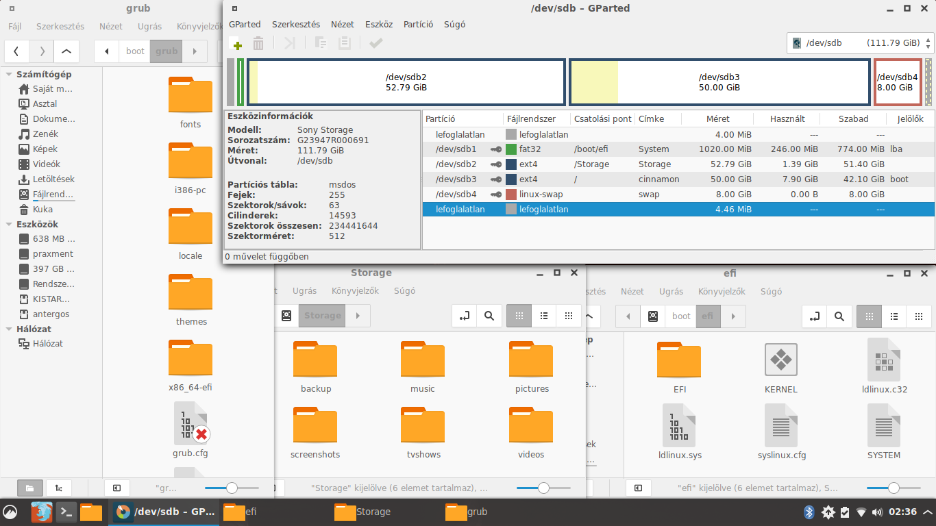

Na most csináltam egy UEFI-s Manjaro telepítést Grub2-vel az usb-s SSD-mre GPT-re saját EFI partícióval és aztán mégegyszer feltelepítettem ugyanabba a / partícióba formázás nélkül, de ezúttal a telepítő pendrájvot legacy módban indítottam és a grubot egy kis pendrájv MBR-es boot szektorába tetettem. Így már valószinüleg tényleg el tudom indítani mindenféle 64 bites PC-n. Simán felment a GPT-s SSD-re a legacy telepítés, csak kell hozzá az MBR-es pendrájv a bootnak. Csinálhatnának már egy ilyen eszközt ami tartalmaz egy nagyobb SSD-t ,s egy USB hubot és egy kis körömnyi pendrájvot all in one-ban és egy USB portba bele lehetne dugni. Ez lenne az igazi svájci bicska!

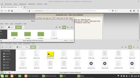

Ez a Gpartedes átméretezés se jó tökéletesen, mert pl. egy bootolható fat32-es pendrájv első (és egyetlen) partíciója átméretezésekor elb@xxa az MBR-t és a Fat táblába sem szerkeszti be a nagyobb partíció új fat tábláját. Tehát ott vagyok egy megnövelt veteményes kert új megnövelt kerítésével , de csak az a terület van benne veteményezésre előkészítve ezután is, ami a változás előtt volt.
Az végül mégsem működik jól úgy, hogy a multibootusb telepítésről készített img-ből kinyerjük a slax mappát és a boot mappából a bootinst.bat , vagy bootinst.sh fájl segítségével tesszük bootolhatóvá a frissen készített pendrájvunkat , mert ez a boot mappa már különbözik az eredeti "gyári" iso fájlból származó slax mappa boot mappájától.Tehát csak 3 mód marad a bootolhatóvá tételre:
1, Az isot kiírjuk egy CD-re , vagy DVD-re
2, Az isoból származó slax mappát tesszük egy pendrájv Ext4-es , vagy Fat32-es első és talán egyetlen partíciójára és a boot mappájában elindítjuk a bootinst.sh illetve Fat32 esetén a bootinst.bat fájlt.
3. Csinálunk egy Fat32-es partíciót a pendrájvra , nevet adunk neki és a multibootusb alkalmazással beletelepítjük az iso fájlt. Ebben az esetben nemcsak Legacyban, hanem UEFI vason is indfítható lesz.Csináltam egy remasterkét... magyar bill, vlc telepítve, firefox a chrome helyett, synaptic, phyton3,5; xfce4-power-manager indítása után működik a fényerő szabályozás, fullra frissítve az egész. Részben működő xfce panel.
sha256sum slax98064ffandanoth.iso txt ,
slax98064ffandanoth.iso . -
