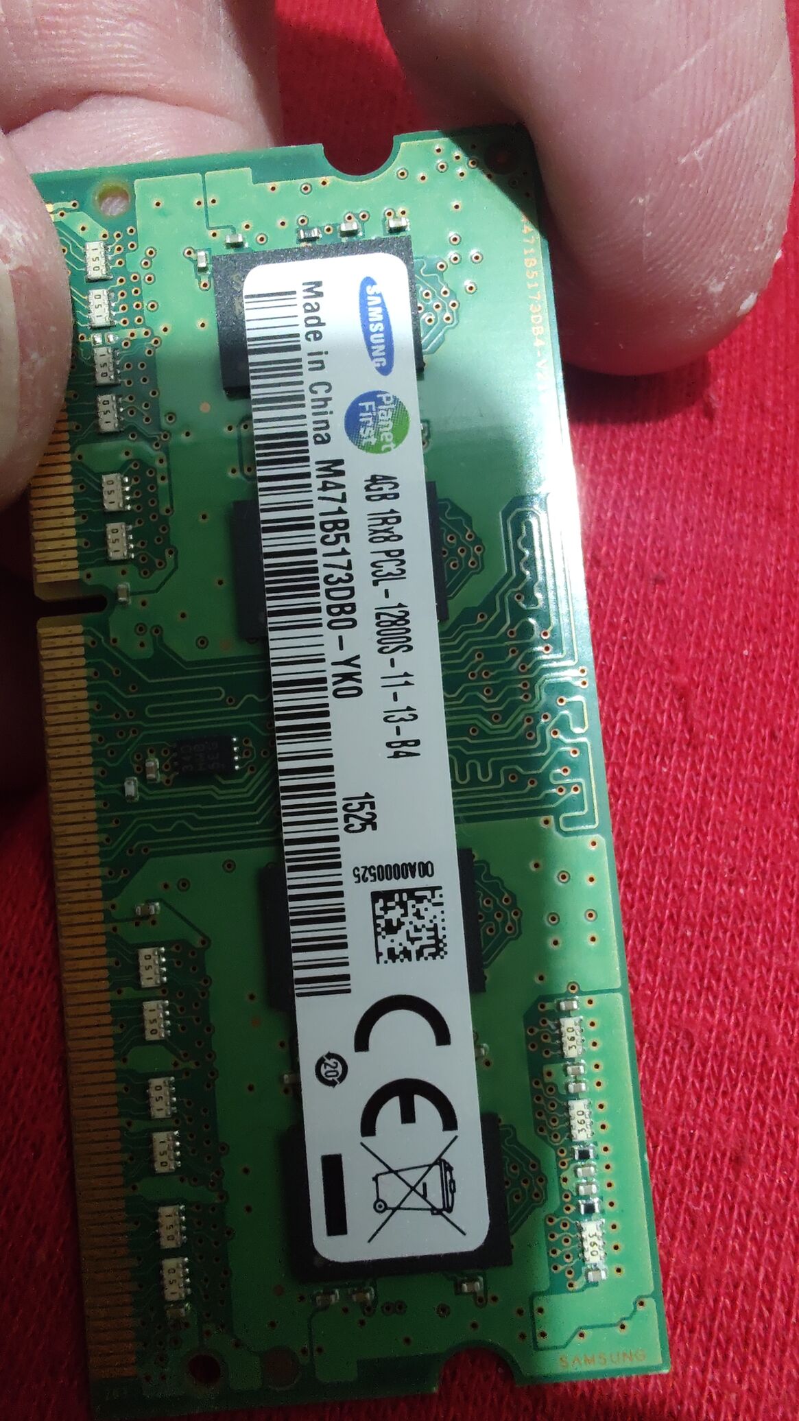

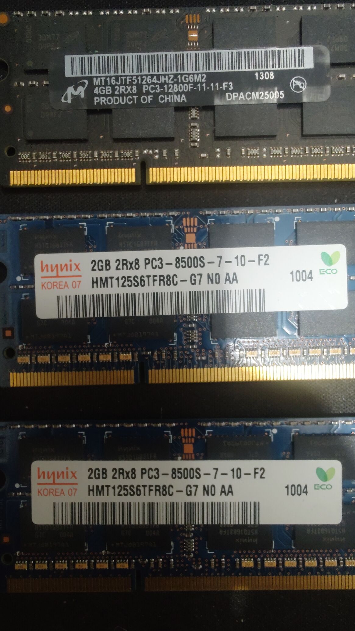

lanszelot #120629 üzenetére
No, meg van hogy miért nem megy vele:
1Rx8 means it is a single-rank module and 2Rx8 means it is a dual-rank module module. Rank is a data block which is 64 bits wide without Error Correction Code (ECC) created using some, or all of the memory chips on a module. The x8 in them specifies the number of banks in the memory module. Higher the number of banks, the fewer the chips in the memory module, the better the reliability and power consumption.
Compatibility is generally not an issue in most cases. But you should go through the motherboard manufacturer's guide of supported RAM modules just to make sure if they are compatible or not.
Coming to the PC3 and PC3L part, PC3 RAMs requires an operating voltage of 1.5V whereas PC3L requires an operating voltage of 1.35V. The 'L' in PC3L signifies Low Voltage. So using PC3 RAM in a PC3L RAM slot will not provide it sufficient voltage and it will fail to operate. On the other hand using a PC3L RAM in a PC3 RAM slot may damage it due to overvoltage. So PC3 and PC3L RAMs are not compatible with each other.
So in short 1Rx8 PC3L 12800S and 2Rx8 PC3 12800S RAMs are not compatible with each other. But if it is only the 1Rx8 and 2Rx8 in concern, they may be compatible with each other"Tehát a Lenovo ThinkPad T450 'low voltage' azaz 1.35V ramot kezel. Tehát nekem PC3L kell.
