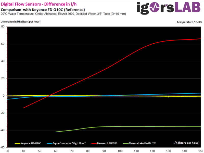

Pug
fudi2002 #86568 üzenetére
Természetesen, anno Igor kimérte.
Summary and conclusion
Take the 50 Euros (or whatever you just wanted to throw out the window) and buy the children a fat pot of ice cream or a bottle of supple shampoo for the Holde, depending on the. But do not deceive yourself with such false detectors, the purpose of which is solely to camouflage and deceit. Those who like to lie to themselves in their pockets are of course welcome to strike. As an underwater dominam, the two test objects are quite good, because it is guaranteed to hurt. If you really want to do something good for yourself and the system, buy yourself, for example. a high flow of Aqua Computer, even if the Blinki blinki is missing, or leaves it completely.
Then at least you know what you’re reading. And before the oppressive soup shrugs off the hoses, because you push through far too much water (thermaltake), or you do not dare to drive the pump higher (Barrowch), because the flow meter already fakes the heaviest swell, then one better dispenses with the display and concentrates on finding the truth. What the high-flow really lacks is the gamer-modding-blinkmichtot optics, I’m quite compliant with that. But you can only live with these values, the Custom Loop by the way.
