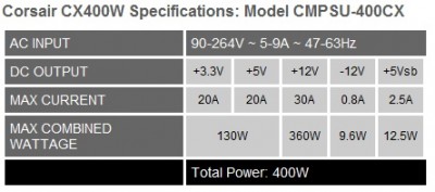

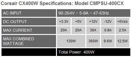

Ha beírogatod a gépedben lévő dolgokat és megadod, hogy húzva van-e a processzor/videokari, stb... akkor ki fogja adni, hogy milyen tápra lenne szükséged. Szerintem lehet, hogy simán kevés hozzá...próbáld ki!
vagy ahogy a guru3d-n írják (bár igaz, hogy itt egy agyonhúzott, alapból is brutál géphez javasolják):
Recommended Power Supply
So here's my power supply recommendation:
Radeon HD 5850
The card requires you to have a 500 Watt power supply unit at minimum if you use it in a high-end system. That power supply needs to have (in total accumulated) at least 40 Amps available on the +12 volts rails.
Radeon HD 5850 CrossfireXA second card requires you to add another 170 Watts. You need a 650+ Watt power supply unit if you use it in a high-end system. That power supply needs to have (in total accumulated) at least 55~60 Amps available on the +12 volts rails.
For each card that you add, add another 200 Watts as a safety margin.There are many good PSUs out there, please do have a look at our many PSU reviews as we have loads of recommended PSUs for you to check out in there. What would happen if your PSU can't cope with the load?:
bad 3D performance
crashing games
spontaneous reset or imminent shutdown of the PC
freezing during gameplay
PSU overload can cause it to break down
