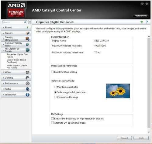

CJ4567 #28011 üzenetére
Elképzelhető. Vagyis biztos:
Requirements to Configure GPU Scaling Option:
- A digital connection such as a DVI, HDMI or DisplayPort™ must be used
- The desktop must be set to a lower non-native resolution. Refer to the display device manual to determine the native resolution. This will be important to know when configuring the display to a non-native resolution -
