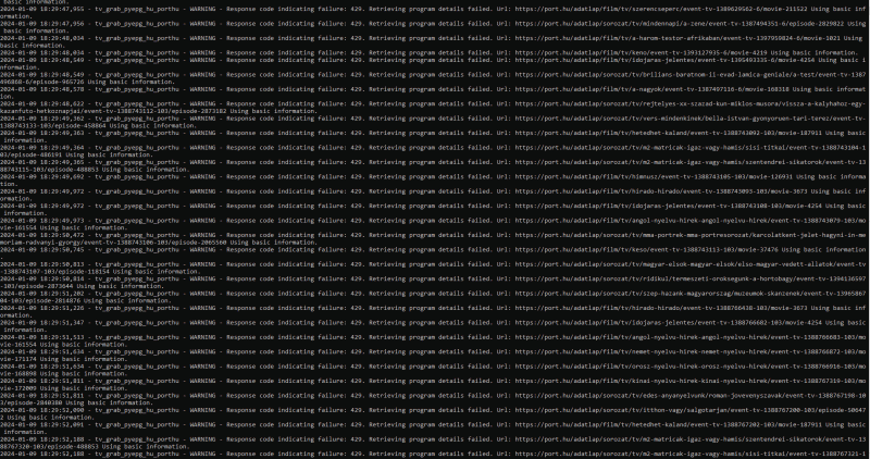

Nálam megint hibát hoz, bár lehet a weboldal nem okés:
2024-05-06 07:58:54,284 - tv_grab_pyepg_hu_porthu - INFO - 15% completed (7104/47354)
2024-05-06 07:59:52,159 - tv_grab_pyepg_hu_porthu - ERROR - Exception occurred while fetching programs
concurrent.futures.process._RemoteTraceback:
Traceback (most recent call last):
File "C:\Python312\Lib\site-packages\urllib3\connectionpool.py", line 536, in _make_request
response = conn.getresponse()
File "C:\Python312\Lib\site-packages\urllib3\connection.py", line 461, in getresponse
httplib_response = super().getresponse()
File "C:\Python312\Lib\http\client.py", line 1419, in getresponse
response.begin()
File "C:\Python312\Lib\http\client.py", line 331, in begin
version, status, reason = self._read_status()
File "C:\Python312\Lib\http\client.py", line 292, in _read_status
line = str(self.fp.readline(_MAXLINE + 1), "iso-8859-1")
File "C:\Python312\Lib\socket.py", line 707, in readinto
return self._sock.recv_into(b)
File "C:\Python312\Lib\ssl.py", line 1253, in recv_into
return self.read(nbytes, buffer)
File "C:\Python312\Lib\ssl.py", line 1105, in read
return self._sslobj.read(len, buffer)
TimeoutError: The read operation timed out
The above exception was the direct cause of the following exception:
File "C:\Python312\Lib\site-packages\requests\adapters.py", line 486, in send
resp = conn.urlopen(
File "C:\Python312\Lib\site-packages\urllib3\connectionpool.py", line 844, in urlopen
retries = retries.increment(
File "C:\Python312\Lib\site-packages\urllib3\util\retry.py", line 470, in increment
raise reraise(type(error), error, _stacktrace)
File "C:\Python312\Lib\site-packages\urllib3\util\util.py", line 39, in reraise
raise value
File "C:\Python312\Lib\site-packages\urllib3\connectionpool.py", line 790, in urlopen
response = self._make_request(
File "C:\Python312\Lib\site-packages\urllib3\connectionpool.py", line 538, in _make_request
self._raise_timeout(err=e, url=url, timeout_value=read_timeout)
File "C:\Python312\Lib\site-packages\urllib3\connectionpool.py", line 370, in _raise_timeout
raise ReadTimeoutError(
urllib3.exceptions.ReadTimeoutError: HTTPSConnectionPool(host='213.181.199.37', port=443): Read timed out. (read timeout=10)
During handling of the above exception, another exception occurred:
File "C:\Python312\Lib\concurrent\futures\process.py", line 263, in _process_worker
r = call_item.fn(*call_item.args, **call_item.kwargs)
File "C:\Python312\Lib\concurrent\futures\process.py", line 212, in _process_chunk
return [fn(*args) for args in chunk]
File "C:\Python312\Lib\site-packages\pyepggrab\grabbers\hu_porthu\request_proc.py", line 59, in gen_programs
rsp = cls.session.get(
File "C:\Python312\Lib\site-packages\requests\sessions.py", line 602, in get
return self.request("GET", url, **kwargs)
File "C:\Python312\Lib\site-packages\requests\sessions.py", line 589, in request
resp = self.send(prep, **send_kwargs)
File "C:\Python312\Lib\site-packages\requests_ratelimiter\requests_ratelimiter.py", line 87, in send
response = super().send(request, **kwargs)
File "C:\Python312\Lib\site-packages\requests\sessions.py", line 703, in send
r = adapter.send(request, **kwargs)
File "C:\Python312\Lib\site-packages\pyepggrab\grabbers\hu_porthu\use_ip_adapter.py", line 79, in send
return super().send(request, *args, **kwargs)
File "C:\Python312\Lib\site-packages\requests\adapters.py", line 532, in send
raise ReadTimeout(e, request=request)
requests.exceptions.ReadTimeout: HTTPSConnectionPool(host='213.181.199.37', port=443): Read timed out. (read timeout=10)
File "C:\Python312\Lib\site-packages\pyepggrab\grabbers\hu_porthu\hu_porthu.py", line 370, in retrieve_guide
progs = fetch_prog_info(progjsons, options)
File "C:\Python312\Lib\site-packages\pyepggrab\grabbers\hu_porthu\hu_porthu.py", line 162, in fetch_prog_info
for result in ppe.map(
File "C:\Python312\Lib\concurrent\futures\process.py", line 647, in _chain_from_iterable_of_lists
for element in iterable:
File "C:\Python312\Lib\concurrent\futures\_base.py", line 619, in result_iterator
yield _result_or_cancel(fs.pop())
File "C:\Python312\Lib\concurrent\futures\_base.py", line 317, in _result_or_cancel
return fut.result(timeout)
File "C:\Python312\Lib\concurrent\futures\_base.py", line 456, in result
return self.__get_result()
File "C:\Python312\Lib\concurrent\futures\_base.py", line 401, in __get_result
raise self._exception
requests.exceptions.ReadTimeout: None: None -

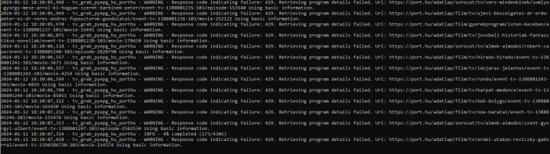

Atomantiii
Van két újabb ismeretlen kategória: werkfilm és opera.
Illetve nekem ma hibaüzenet jön fel 58 %-nál, de lehet csak a weboldal nem válaszol.
response.begin()
raise value
urllib3.exceptions.ReadTimeoutError: HTTPSConnectionPool(host='213.181.199.38', port=443): Read timed out. (read timeout=10)
requests.exceptions.ReadTimeout: HTTPSConnectionPool(host='213.181.199.38', port=443): Read timed out. (read timeout=10)
File "C:\Python312\Lib\site-packages\pyepggrab\grabbers\hu_porthu\hu_porthu.py", line 161, in fetch_prog_info

atomantiii@raspberrypi:~/.xmltv $ tv_grab_pyepg_hu_porthu --verbose
2024-03-11 11:25:06,491 - tv_grab_pyepg_hu_porthu - INFO - retrieving programs from 2024-03-11 to 2024-03-22 for 124 channel(s)
KilőveA többi konfig a fájlban van megadva. Mondjuk a jobs, ratelimit és az interval 1-esen van, mert olyan lassú a raspberry pi, hogy valószínűleg nincs értelme variálni, mint a pc-n de lehet mégis fentebb kell venni az értékeket.

Így próbáltam futtatni:
tv_grab_pyepg_hu_porthu --slow --jobs 4 --ratelimit 9 --interval 5 --verbose --day 2 --output /home/atomantiii/epg/port.hu.xmlA /home/atomantiii/.xmltv-ben van a conf fájl és létezik ez a fájl is: /home/atomantiii/.local/lib/python3.9/site-packages/pyepggrab/resources/xmltv.dtd
Mióta csak a konyakmeggy.xml.xz-re van megadva a hivatkozás a azóta elsőre betölti az adatokat a beltéri.
Ha nem írom be az --output részt akkor ezt kapom:
atomantiii@raspberrypi:~ $ tv_grab_pyepg_hu_porthu --slow --jobs 4 --ratelimit 9 --interval 5 --verbose --day 2

Max500
Egyenlőre annyi fejlemény, hogy --jobs 1-el és 9/5-el jól működik (és az összes olyan variáció ami nem lépi túl a 2 kérés/mp-t).
Helyzet:
Linux natív: ok
Windowson Linux VM: ok
Windowson WSL: nem ok
Windows natív: nem ok
Linuxon Windows VM: nem ok
Egyenlőre fejet vakarok, még nem látom az okát -
