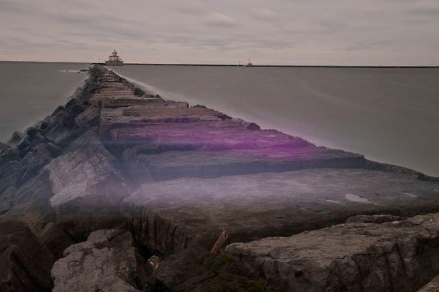

Most nincs nálam a kép, de valami ilyesmi jelent meg nálam is: [link]
Igazából ismert a probléma, ezek szerint 12mm-en DX-en 30mp-es idővel f/8 nem az ideális beállítás ilyen célra, vagy legalábbis abban a szögben:
"One of the shooting specs he sent me leapt out at me – f22 and smaller. I suspected that was the problem, and when I researched it a bit I found someone else with the exact same problem with the exact same filter and who also used f22. My suggestion was to not stop down so far and be aware of the camera’s diffraction limit (discussed above). Joe tried this and it worked. I’m no expert but I suspect the hazy effect happens all the time when you greatly exceed the camera’s diffraction limit and that we just don’t see it as pronounced until we do a long exposure. Then again, I may just be pissin’ in the wind!"
